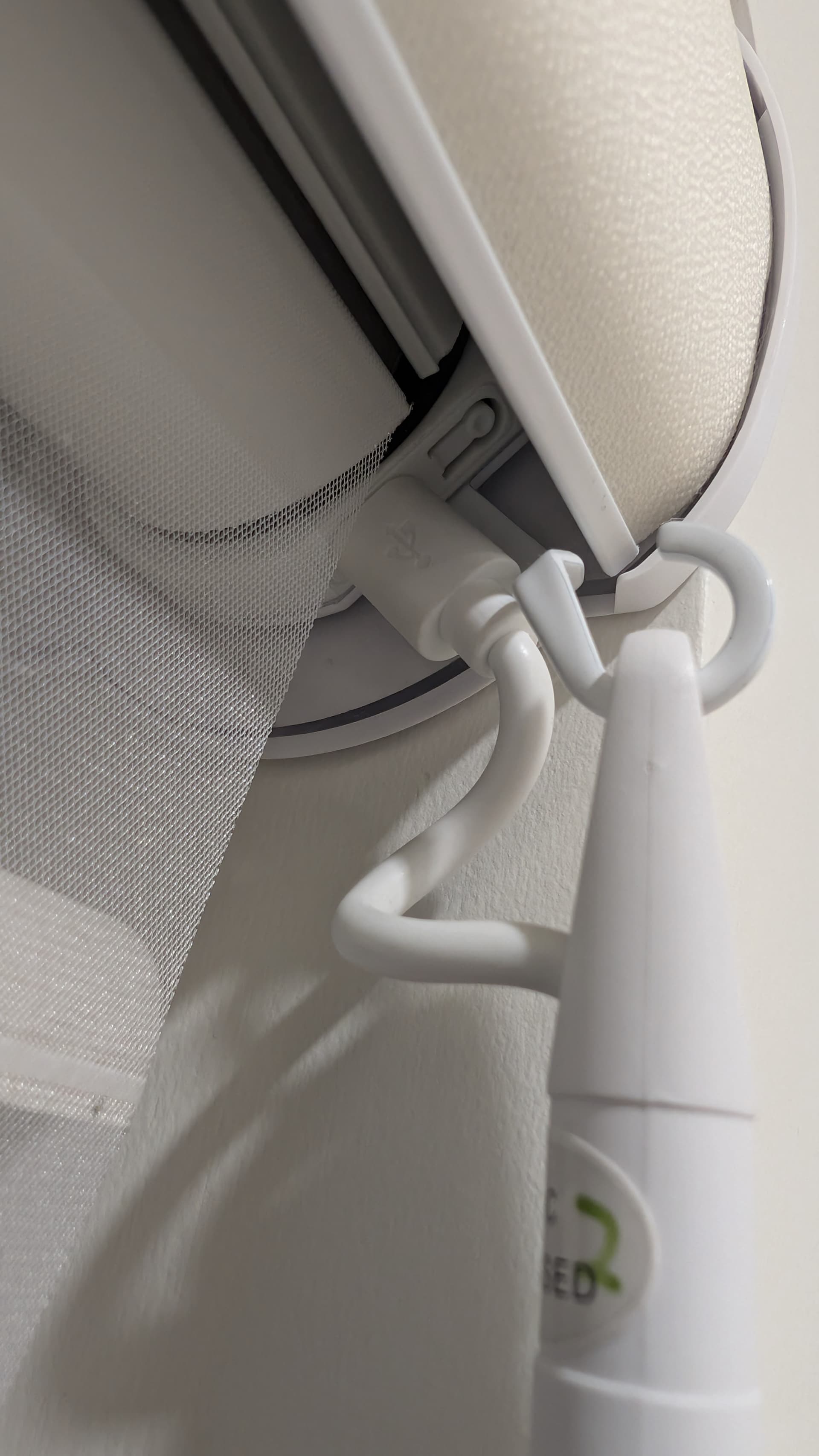

Micro USB controller between blinds motor and power wand
Driving me crazy I can’t get these smart homed. The previous owners had the majority of the blinds connecting to the Alta blinds hub but not the ones along the street, which is where I’d definitely want them every night closing before bed time.
Technical wise I’m useless with creating any sort of device so even with someone mentioning in a post on Facebook I couldn’t figure out what would be the steps to make it. Does anyone have any tips or alternative solutions?
From their post:
“I connected mine to HA with a NodeMCU and ESPHome. I can control with the wand or through HA. I spliced the wand’s “USB” inputs into NodeMCU i/o ports to monitor button presses. Output from NodeMCU i/o via “usb” to the roller, emulating the wand button presses. The NodeMCU is hardwired to power. The “USB” connection from the wand is not a true USB data connection.”
Is this the nicest solution? Smaller/better alternatives?
