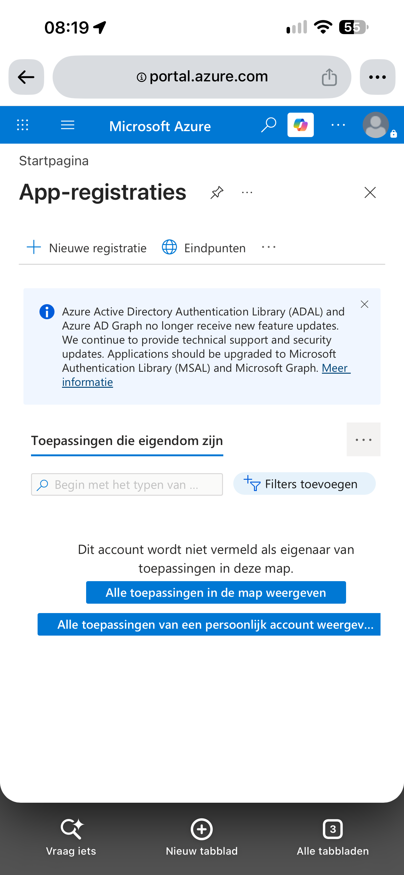

Ok, 1st question when i go to azure,
It says im not owner:

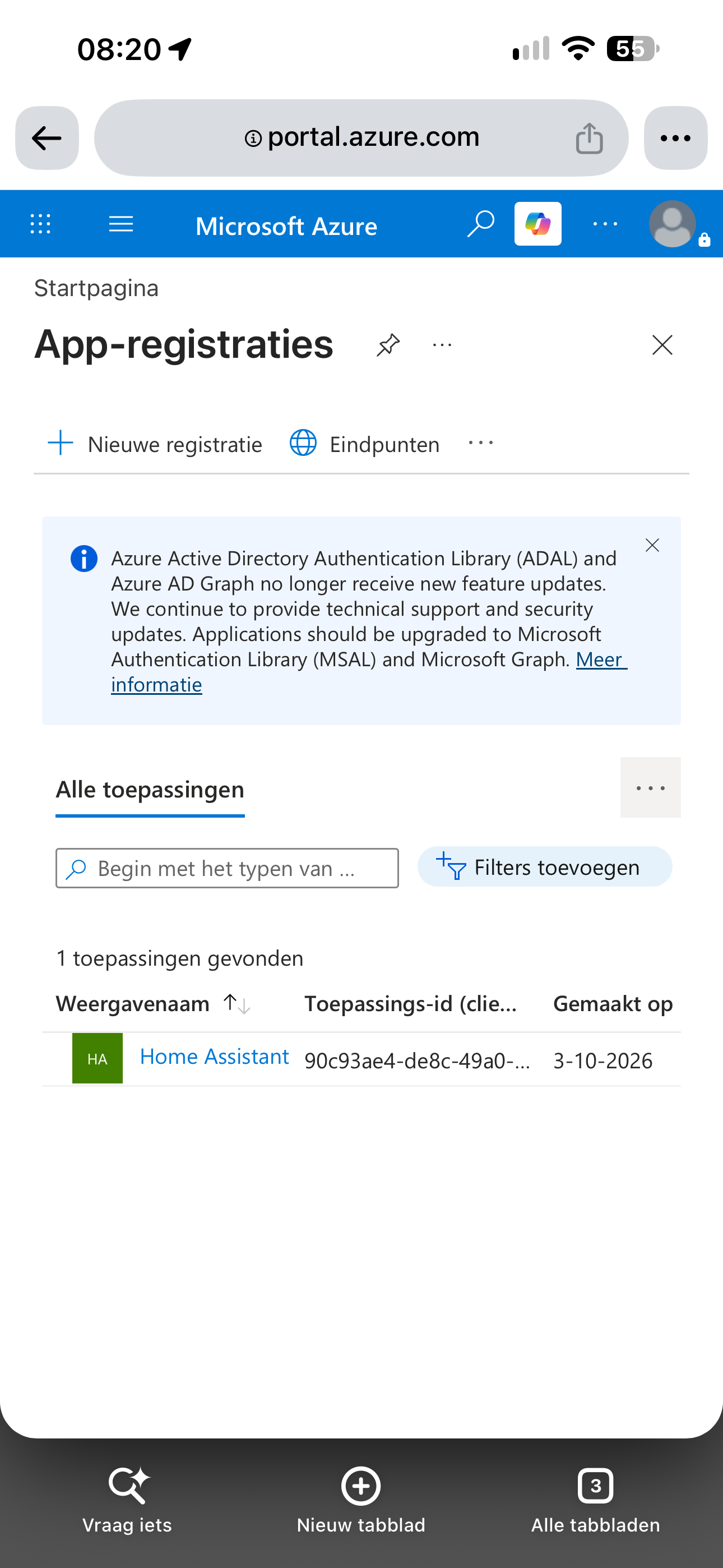

While if i select all, i get this screen
Did i already make a mistake here?
Not broken m you registered the app so that’s a good start. (also sorry my Dutch sucks so I may misread some)
Click Home Assistant.
Now check that app against the prerequisites one item at a time.
on the app’s Overview page, tell me what it says for Supported account types. DO NOT post your Client ID or any secrets.
