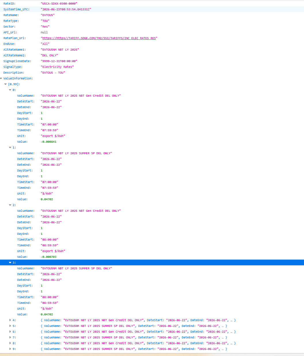

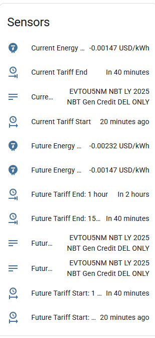

My TOU tariff is locked onto the export credit stream. Are there 2 associated streams?
From your screenshot there it looks like the utility company crammed both the generation and the consumption tariffs into the same RIN. They are supposed to do 2 separate RINs for that but if you put a feature request in on GitHub with these screenshots and the plan you're on I can see if that data is extractable into 2 sets of sensors.
Done. Thank you so much! This should help anyone with SDGE and specifically TOU5
