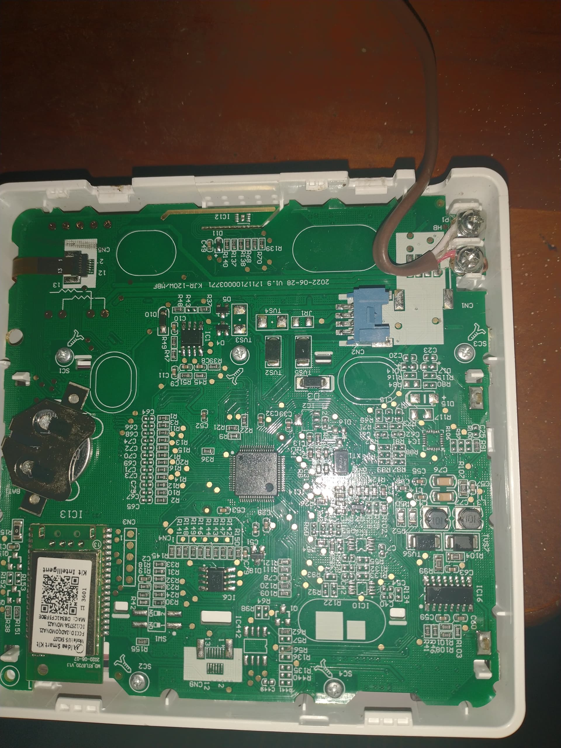

The wired controller uses like 5 or 6 pins, could you dhare pictures of how this is connected, the HA/HB terminals are only 2 PIN with both data and power (~20VDC)
@Oscar_Calvo
There is an HA & HB terminal on the wired controller, pictured. On the AHU is also a dedicated HA & HB termnal block. Cant get any simpler than this. Has worked great since September 2025. I know everyone has a better mouse trap for a tstat. Wouldn’t change this one for anything.
I rechecked with multilmeter. voltage reading flucuates very slightly.
between 18.83 - 18.84VDC,ten seconds then back and so on,never goes beyond these parameters.
Kind of leary trying to connect my rs485 module to this,as i dont have a spare air handler / controller board laying around :slight_smile: ChatGPT says is ok, to hookup to these two wires,but have never actually seen anyone saying they have gotten anything useful in regards to HA using the HA & HB terminals.
I have seen a hookup about two years ago where someone did hook to these terminals,but also had the conventional 5 wire tstat/controller, XYE 24VDC connection to air handler initially also,so on your setup,you should be able to hookup like i am wanting to do.
TIA

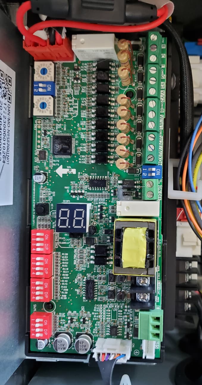

Greetings,
I am trying to connect my Senville SENDC-24HF which I understand is a rebranded Midea DLFSABH24XB3 ducted mini split to Node-Red via the XYE terminals through a Hexin 2108E RS485 Ethernet Serial Server. I also have a KJR-120N 2 wire (HA/HB) t-stat connected. I’ve been trying to use Claude AI to generate code for the XYE protocol parsing but I’m finding the response bytes aren’t as expected. It seems like AHU responds but not with real data. You can see the reported temps aren’t real and the mode should be HEAT with fan LOW. I realize this is the HA forum so without diving into my NR flow particulars, has anyone seen replies like this from their units?
It also appears that I’m not getting the expected CRC either and the AI can’t figure out what CRC calc is being used. I had the AI study the protocol here https://codeberg.org/xye/xye
Here’s the AI’s latest findings after querying the AHU with several commands.
:mag: CRITICAL FINDING: ALL Commands Return IDENTICAL Responses!
Looking at all your command scanner results:
Command 0x03: 0xaa 0x03 0x80 0x80... (CRC: 0x84) Command 0x40: 0xaa 0x40 0x80 0x80... (CRC: 0x47) Command 0x41: 0xaa 0x41 0x80 0x80... (CRC: 0x46) Command 0xC0: 0xaa 0xc0 0x80 0x80... (CRC: 0xc7) Command 0xC1: 0xaa 0xc1 0x80 0x80... (CRC: 0xc6) Command 0xC2: 0xaa 0xc2 0x80 0x80... (CRC: 0xc5) Command 0xC3: 0xaa 0xc3 0x80 0x80... (CRC: 0xc4)
:rotating_light: The Smoking Gun
Every single command returns:
  • :white_check_mark: Correct response code (echoes the command byte)
  • :white_check_mark: 32 bytes
  • :white_check_mark: Valid frame structure
  • :x: All data is 0x00 or 0xFF
  • :x: CRC varies but is “wrong” by our calculation
But notice: The CRC is consistent with the command!
  • 0xC0 → CRC 0xc7
  • 0xC1 → CRC 0xc6 (one less)
  • 0xC2 → CRC 0xc5 (one less)
  • 0xC3 → CRC 0xc4 (one less)
This means the unit IS responding correctly and the CRC is actually VALID - we just have the wrong algorithm!
:bulb: The CRC Must Be Different
The CRC is decreasing by 1 for each command code increase. This suggests the CRC algorithm is actually working, but uses a different formula than we thought.
Let me check if it’s just a simpler checksum:Hmm, that didn’t work. But here’s the key insight:
:dart: The Unit IS Responding!
The fact that every command gets a response with:
  • Correct response code
  • Proper 32-byte length
  • Consistent CRC pattern
Means the heat pump IS communicating, but it’s intentionally sending all zeros/0xFF!
:thought_balloon: Why Would It Do This?
The unit is saying: “I acknowledge your query, but I’m not giving you operational data.”
This could be because:
  1. SW1-1 might also need to be ON (not just SW1-4)
  2. Both SW1-1 AND SW1-4 need specific combination
  3. Unit needs to be in a specific state (not just running, but in CCM mode)
  4. There’s a lock/unlock sequence required before data is provided
:wrench: Next Test: Try SW1-1 = ON
Your manual says:
  • SW1-1 OFF = RS485/S1-S2 mode (for thermostat)
  • SW1-1 ON = 24V mode
But maybe for full XYE data, you need BOTH SW1-1 and SW1-4 ON?
Try This DIP Switch Setting:
SW1: ON-OFF-OFF-ON
     ││  │   │   └─ ON: 1001/XYE mode
     ││  │   └───── OFF: Heat pump
     ││  └───────── OFF: Anti-cold blow
     │└───────────── ON: Try enabling this!
The unit IS responding correctly - it just won’t give you data yet! :closed_lock_with_key:
Want to try SW1-1 = ON?
As far as I understand, SW1-1 ON would set it for 24V control which I don’t want. I’m not sure where it’s getting the idea to turn SW1-1 ON.
Thanks for the reply,

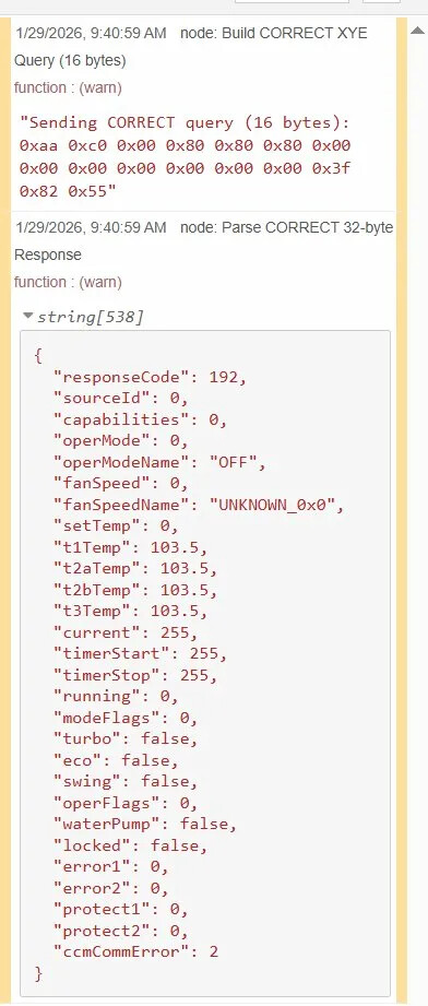

I added the 120ohm R but the replies are the same. And it seems the AHU also ignores the query’s CRC, I sent a CRC of 0x00 and it replies just the same. Changing the source ID also has no effect on the reply’s payload. But changing the destination ID to anything other then 0x00 (even 0xFF) causes there to be no reply.
I have been able to figure out that the CRC matches if I only calc the payload in the reply. So I went back to my query frame and updated the CRC there to also only calc the payload portion but the replies still have what appears to be dummy data, as if the AHU is not authorized to reply with real data.
So I’m able to match the CRC but my replies are still useless.
The AI had me try a few different command bytes and the replies are all identical except for the Command Byte and CRC Byte matched their respective command byte in the test.
Currently I’m connected to the removable green XYE in the lower right corner but my AHU also has a connector labelled S-485 that I’m tempted to try too.
:wink:
I have made progress! I have to calculate the CRC on bytes 1 to n-2 (2nd byte up to and including the 3rd last byte in the packet). So that’s all the bytes excluding the preamble, CRC & suffix/prologue bytes. Once my Query 0xC0 has the proper CRC then the reply packet has useful data. This doesn’t surprise me but this is the first time I’ve see this specific combination of bytes mention for Midea XYE CRC calculations. I am surprised though that the AHU replies at all with an incorrect Query CRC.
There also appears to be some differences in the oper mode and fan bytes, it appears I will have to capture the data in all the various modes to complete the protocol for my AHU.

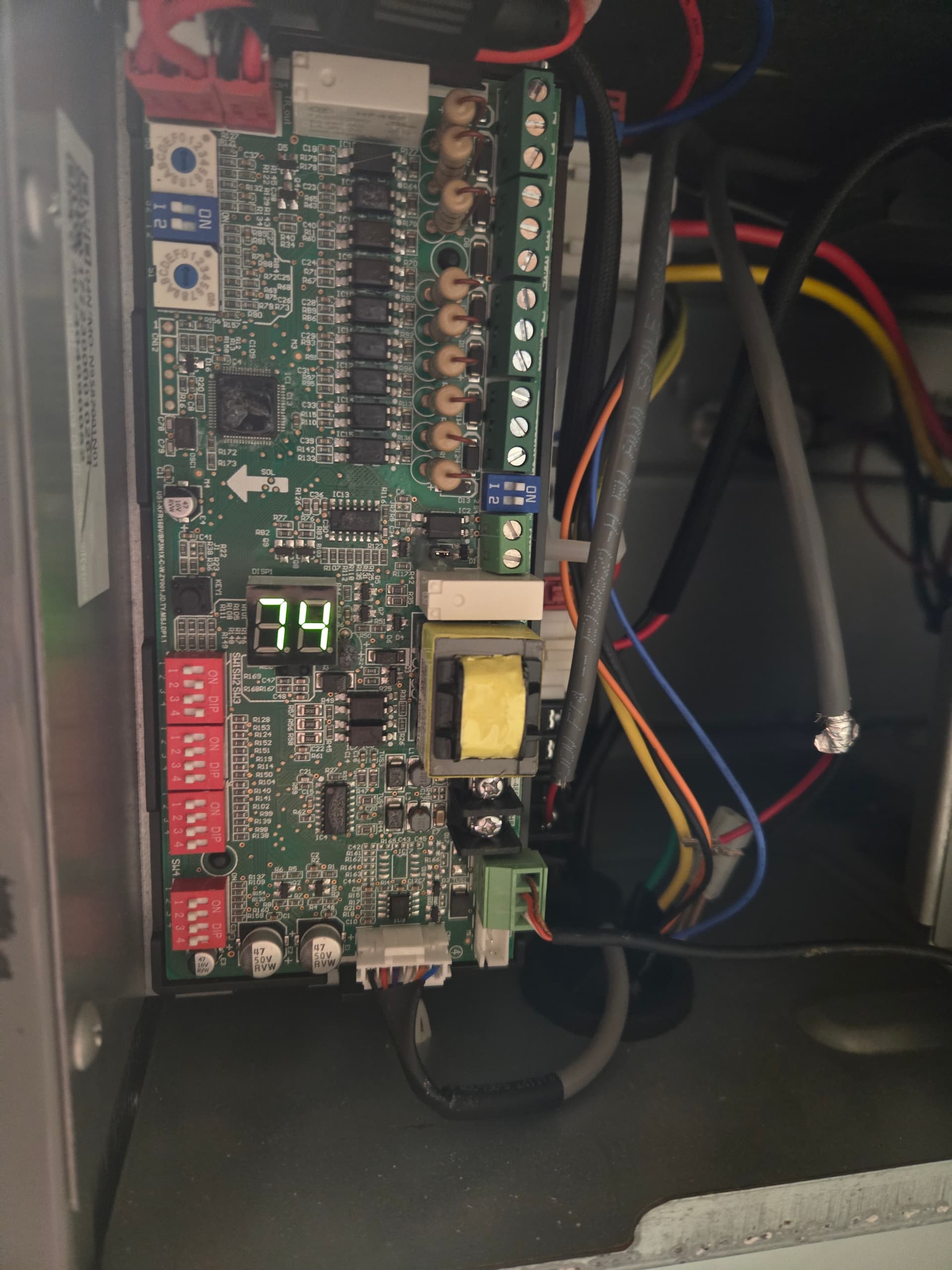

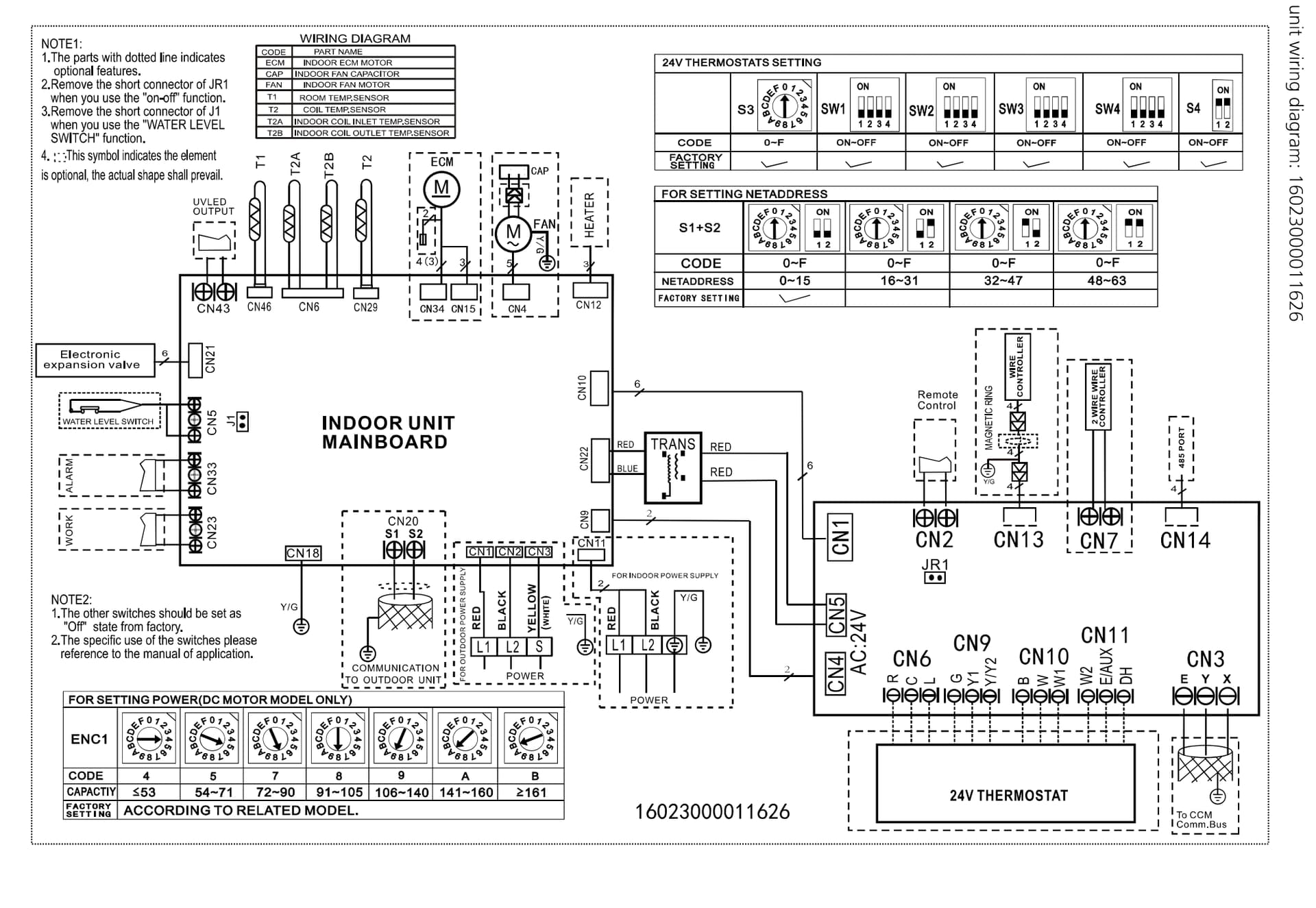

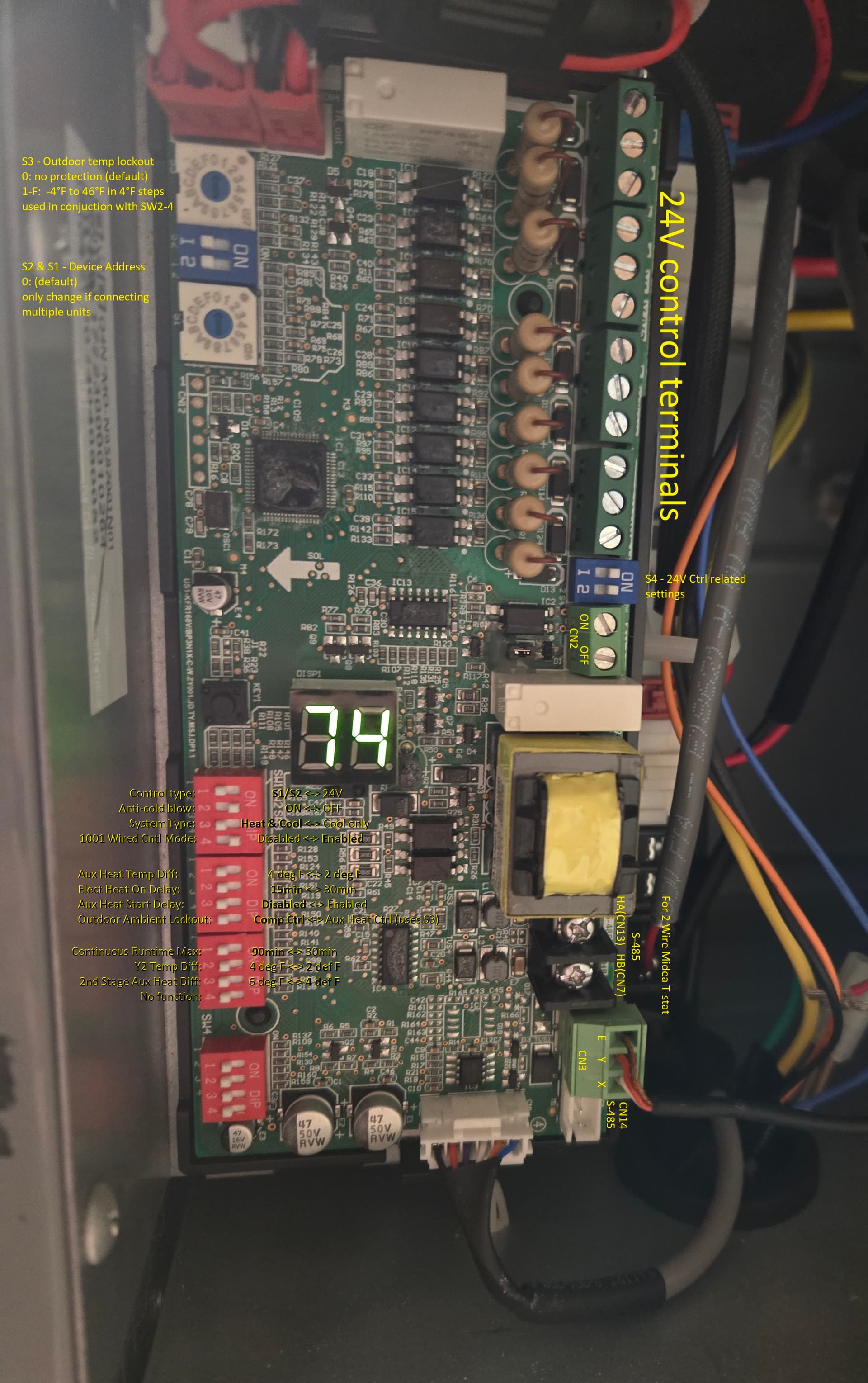

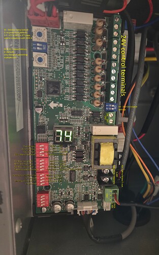

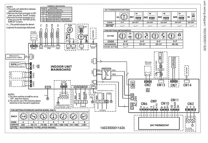

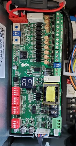

I don’t know what data is being sent along all the comms here. My AHU has a dedicated 2-wire connection (S1/S2) to the outdoor compressor. Then the thermostat has a dedicated 2-wire connection (HA/HB) to the AHU. Then there’s this XYE and S-485 connections on the AHU communications PCB. :exploding_head:
Here’s my labelled PCB photo
Here’s the best schematic I have for the AHU so far.
I would not flip that switch. In 24V mode, the unit will become “dumb”.
What I would do instead is disconnet the t-stat completely. It could be that you are seeing 2 masters controlling the slave.
In XYE, there can only be one master, and the master is not the internal unit, the internal unit is the slave.
When you are seing a command you are acting as master, but perhaps the t-stat is seeing that traffic and colliding with it.
You want to connect in CN3
Yes, this looks like 2 masters in the same bus. Try disconnecting the t-stat.
Just in case this is helpful: ESPHome-Midea-XYE/esphome/components/midea_xye/PROTOCOL.md at 92957c08c002185e7125be8da501617b3db5167c · HomeOps/ESPHome-Midea-XYE · GitHub
