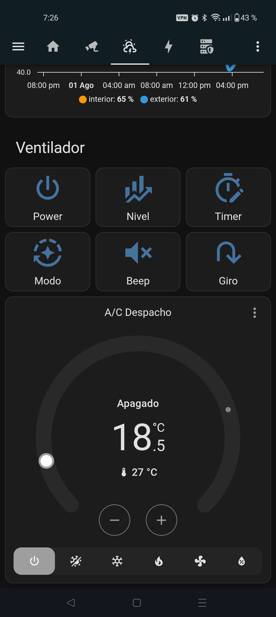

Hello, I’m trying to control a Mundoclima A/C (Spanish brand based on Midea) with an ESP32 C3, based on this video:
ESP32 - Midea A/C
this is the code I use:

But all I get is this on the log:
