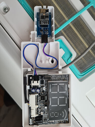

Mine is a carrier, and this is how i connected it.

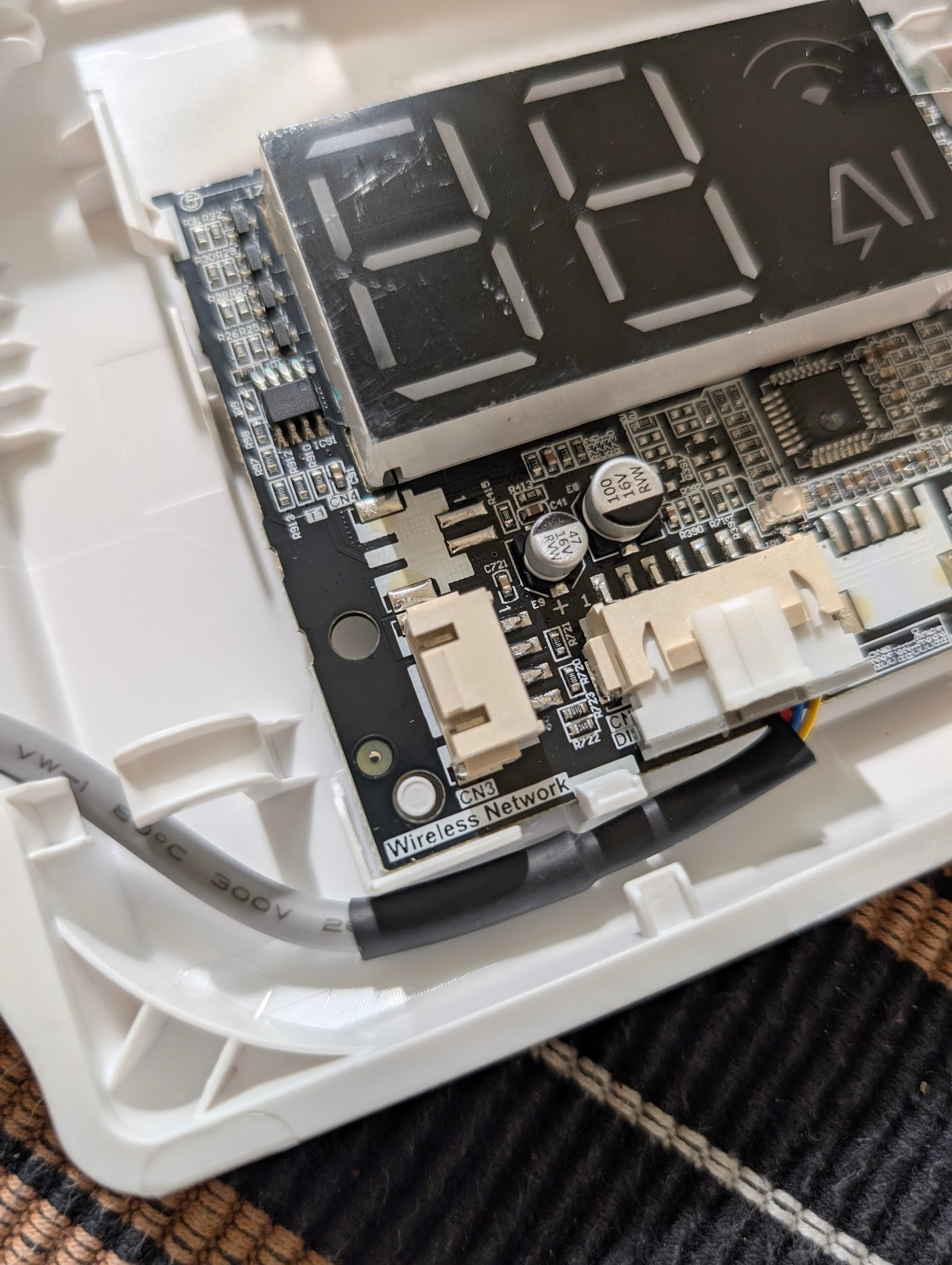

I am trying to integrate a SMLight SLWF-01 Pro into this board (Midea Klyma inverter MSEZ1B-12CRDN8) via the CN3 JST connector:
I tried a female USB-A to JST adapter first: when it was connected, the AC didn't even beep when mains power was turned on (beeps fine without the adapter).
I then soldered in Dupont cables onto the dongle for 5V, GND, TX0, RX0. With just 5V and GND connected, the AC would turn on with beep when mains powered.
Tried swapping RX/TX but never got a signal. Logs:
Logs excerpt:

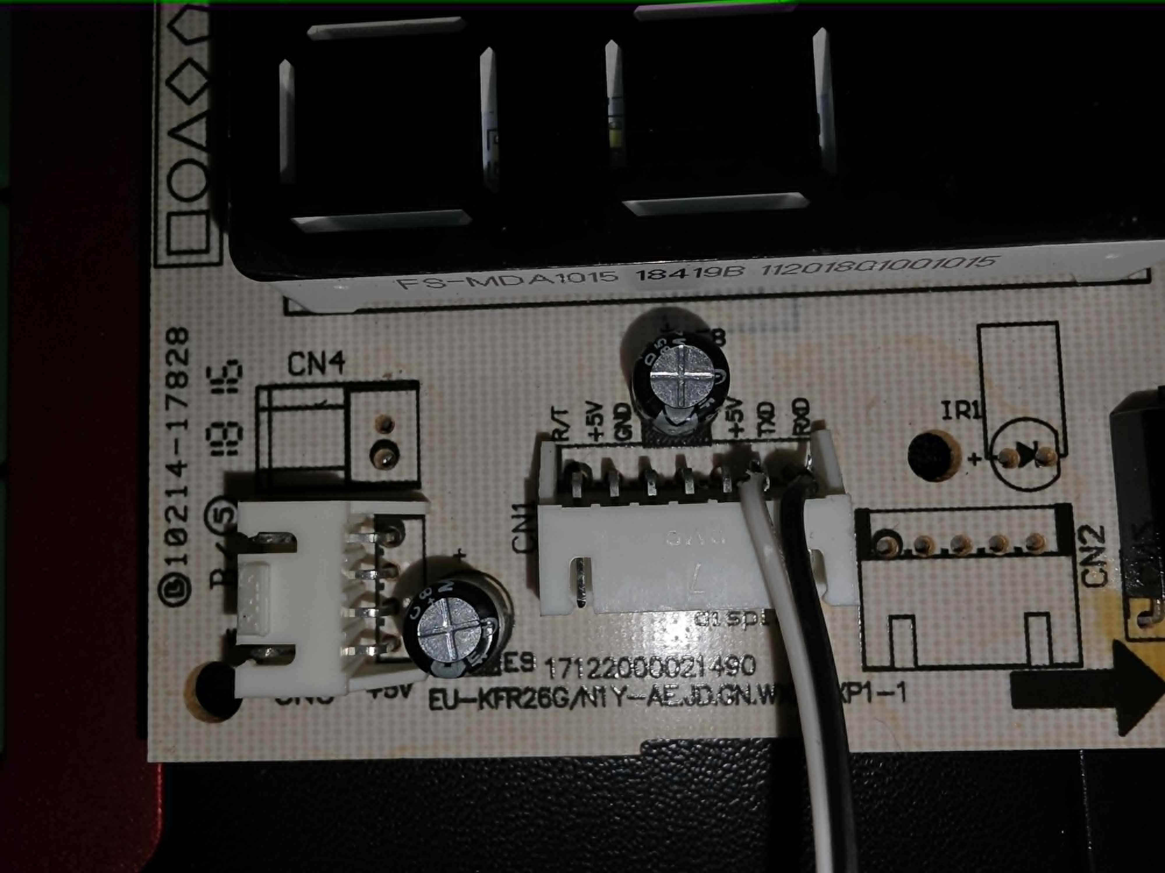

I have Casper with display board have wifi connector but when connect to esp8266 not receive any TX signal from this connector, i have been swap 2 wire but nothing receive

i have a very similar board on my midea wallmounted (its an Bosch branded). I am also looking to find the IR-diode to connect, there is something beloiw the small digit of the display, but it has 4 pins… have you found something to connect to?
