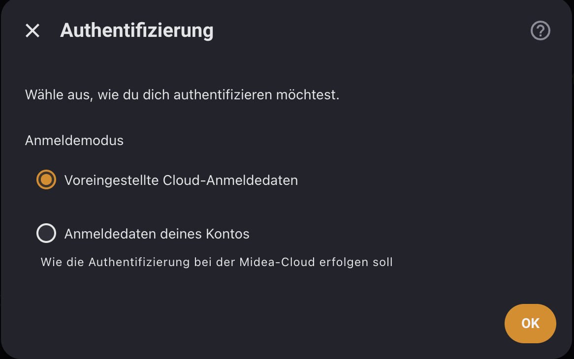

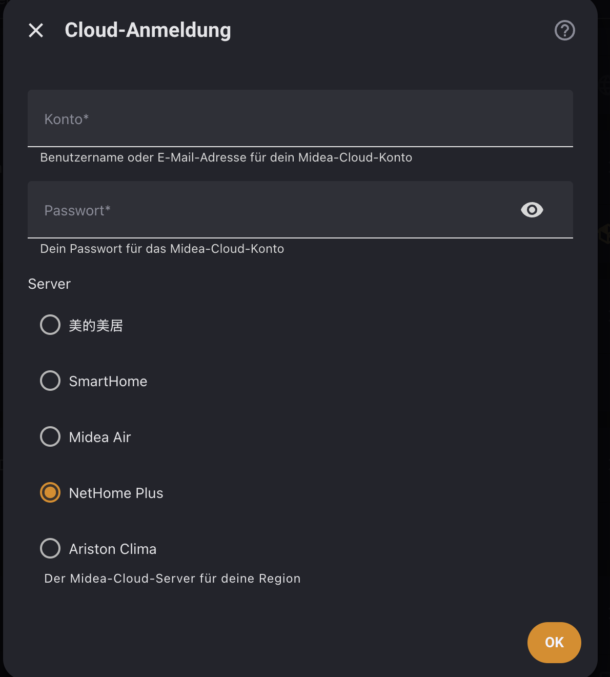

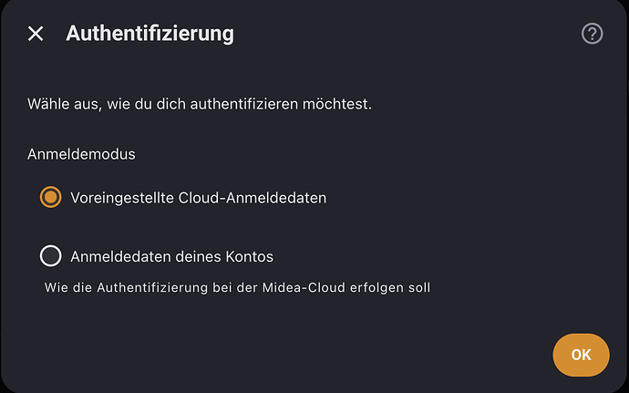

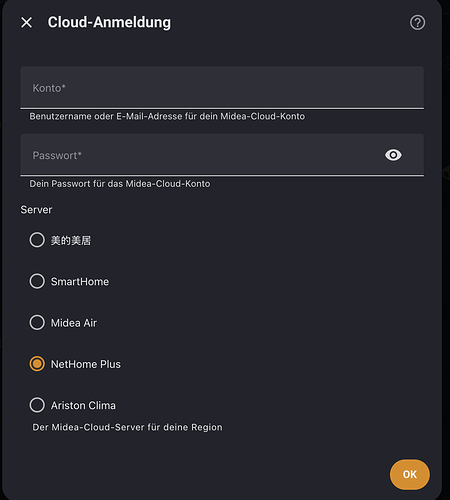

I am wondering about the “LAN” part of the new integration: Midea AC LAN connects locally. The Midea integrations asks me for cloud credentials:
Why does it need cloud credentials? In my network the AC is not allowed to talk to the internet (because it should not need to). The communication works perfectly fine in the old Midea AC LAN integration. Am I missing something about the local part?
Midea core integration is fully local.
It needs a cloud connection only once to retrieve the token and key for that device.
If you have them already (for example from the old custom), you can use the manual configuration instead of the discovery.
Thanks!
I was able to configure the devices manually with the values from
jq -r '.data.entries[] | select(.domain=="midea_ac_lan") | {title, data}' config/.storage/core.config_entries

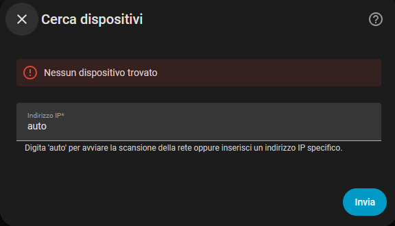

Hi All

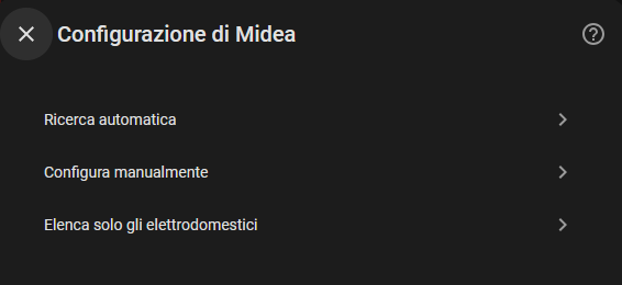

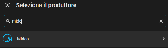

I’m new in HA. I installed it as container in my QNAP and seems work quite good except for MIDEA integration.
I tried with standard MIDEA integration, but no devices are discovered.
Then I tried with MIDEA AC LAN, same result.
The only inbtegration that is working is MIDEA AUTO CLOUD, but I don’t like too much because it requires internet and current temperature is not working.
When I try to add the MIDEA HEAT PUMP with MIDEA integration, I have following messages
Is there anyone can help me ?

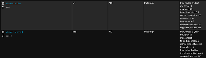

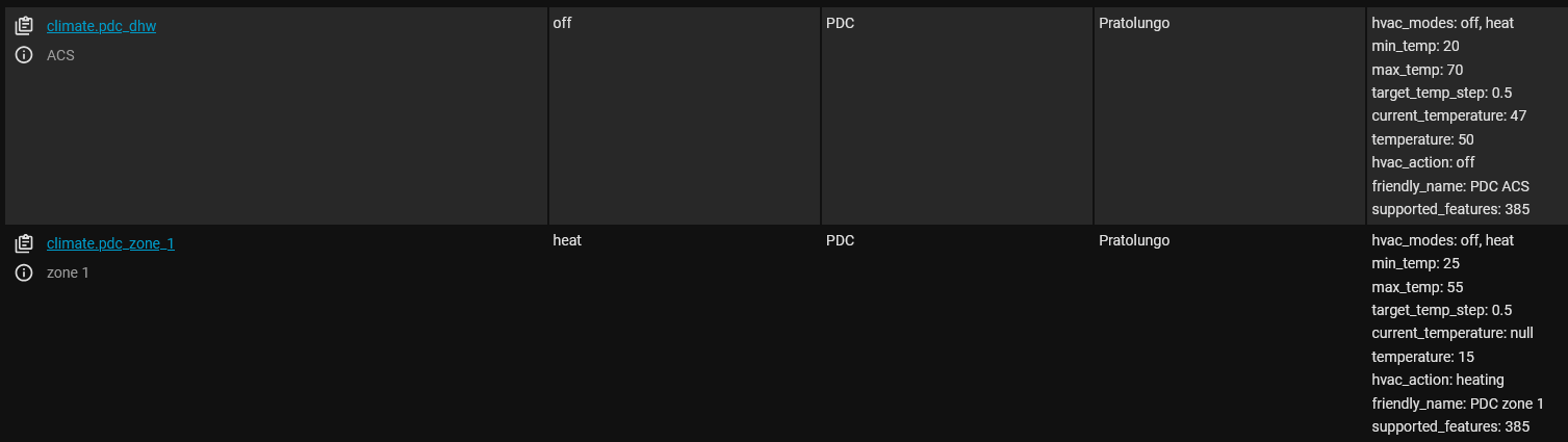

If I look to the states, I can see that current temperature for hot water (boiler ) is ok, while the current temperature for fancoil is not (current_temperature: null)
