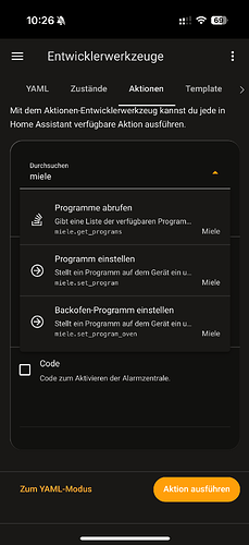

Nevermind, after posting I got the idea to check the developer tools for a service:
Using that in an automation or script will do the trick I think.
Just documenting if anybody else wonders how to do it.

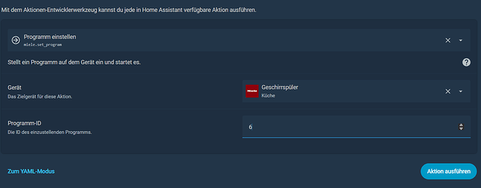

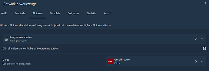

That is super easy. Auto would be program 6 for example. You can check the numbers here with miele.get_programs:
It will return a list. You can then select a program with miele.set_program:
I used this to create a script:
check if dishwasher is on
if not turn on (this yields an error atm while still turning it on, since the last update, trying to figure this out)
set program 6 (now it starts automatically if the door is closed)
I don’t remember how I found out the program number, but here is the working automation. It’s critical to wait until the status has changed before moving on:
