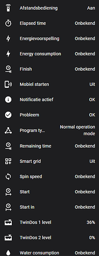

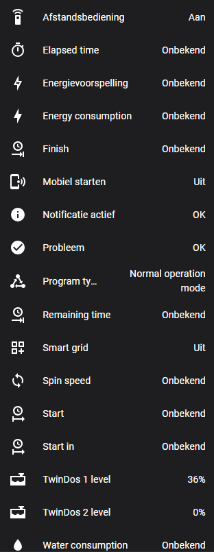

I’ve removed the Miele integration and HACs. I’ve restarted Home Assistant. The Miele was already installed through devices and services ( home assistant core), so I didn’t have to log in or enter a password. Is this normal?

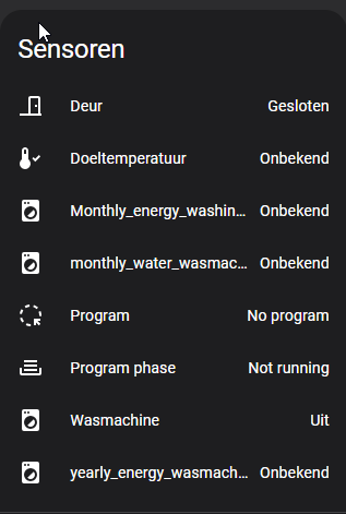

Now I see that certain sensors are unknown (onbekend). Is this normal, or does the washing machine need to be tested first for these sensors?
If the integration is built-in, then I recommend you go to the integration and delete your entries. If you used HACS integration, maybe the integration provided different sensors that the HA build-in one.
Home assistant will then (most likely, if auto detect is enabled) show you that new device is available and you can add it.
