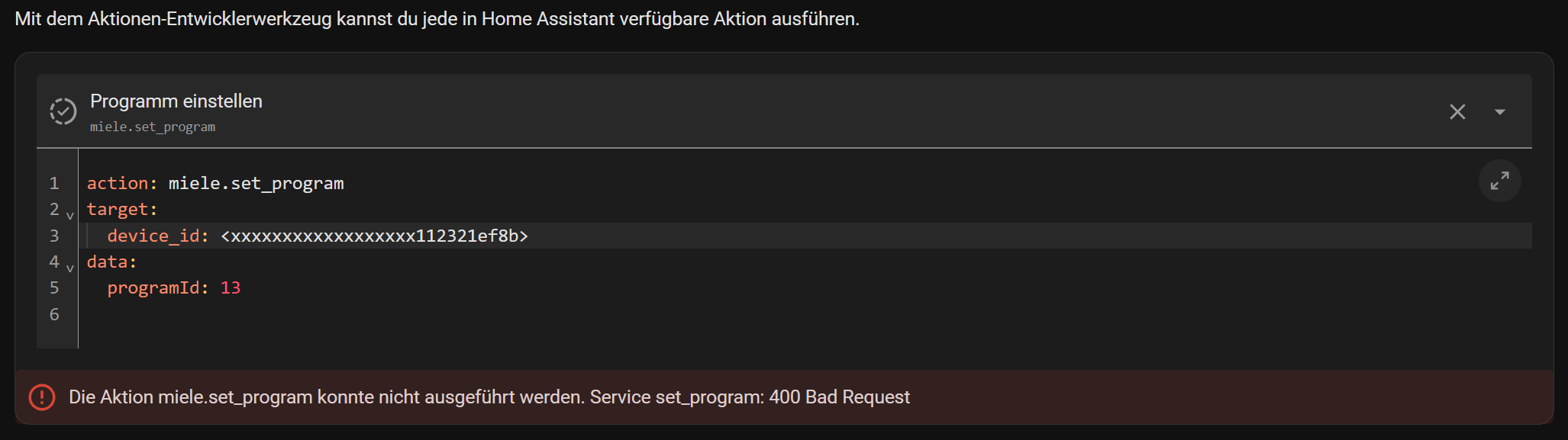

I have an issue with my dishwasher. I wanted to start it with the miele.set_program command but I always receive an error message:
Die Aktion miele.set_program konnte nicht ausgeführt werden. Service set_program: 400 Bad Request
Does anyboady know why this is not working? I checked it a couple of weeks ago and everything was fine
I am using a miele G7665 Dishwasher
…ok, I saw, that this feature is not supported anymore!
What do you mean by “anymore”? Is it no longer supported by the Miele API or is the functionality not available because of the switch from the HACS to the official integration?
…the switch from HACS
Looks like set_program is coming soon :partying_face:

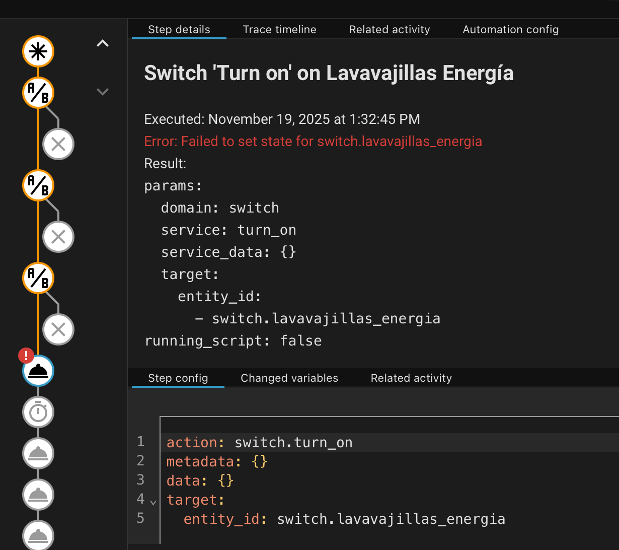

Hi There!
Since one month approx my miele integration is giving me some errors in the automation to start the dishwasher.
Here is the trace log for the automation error.
However I see the dishwasher is turning on, but the command fails with this error, so the automation fails
Is there any other having same behaviour?
Thanks
