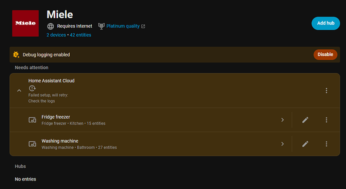

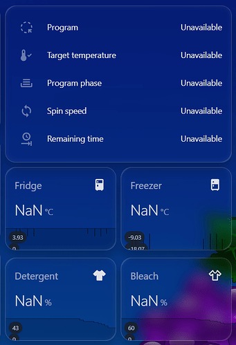

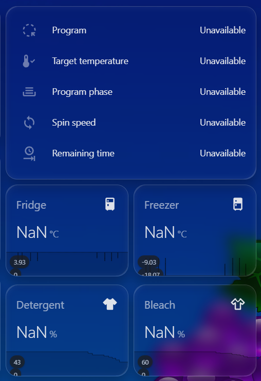

I recently bought a new Miele fridge-freezer and a washing machine and added them to Home Assistant with the Miele integration (official, non HACS). It worked fine for a week then suddenly I get NaN errors in mini graph card and unknown in Entities card about every 10 seconds on and off.
I think it started after a HA update or when I added the fridge and washing machine to a new test install of HA.
I have tried shutting down the new HA install, deleting the Third party apps HA entry in the Miele app and setting up the Miele integration again, and changing the Home Assistant Instance back to my old one.
Anyone having the same problem? Here is a log and some screenshots, please tell me if you need something more.

same error here. below is the summary from my claude code HA session:
Same issue here on HA 2026.7.4. Two washer/dishwasher-class devices. Exact same Timeout fetching miele data from homeassistant.components.miele.coordinator.
One thing that might be useful to add to the diagnosis: in my logs I also see this from the underlying pymiele library:
WARNING [pymiele.pymiele] Connection was closed, restarting
ERROR [pymiele.pymiele] Listen event: Response payload is not completed:
       <TransferEncodingError: 400, message='Not enough data to satisfy transfer length header.'>
That’s Miele’s cloud closing chunked HTTP responses mid-stream with an incomplete payload — i.e. the server is truncating the response before it finishes. So the 10s coordinator timeout is a symptom, not the root cause. The root cause looks like it’s on Miele’s side, which is probably why re-adding the integration or resetting the app doesn’t help.
Entities recover on the next successful poll for me, so it’s cosmetic log noise rather than a functional failure. If it’s bugging you, this silences it without hiding real errors:
logger:
  logs:
    homeassistant.components.miele.coordinator: error
    pymiele.pymiele: error
Not a fix — just a mute button while we wait for Miele to sort out their API.
