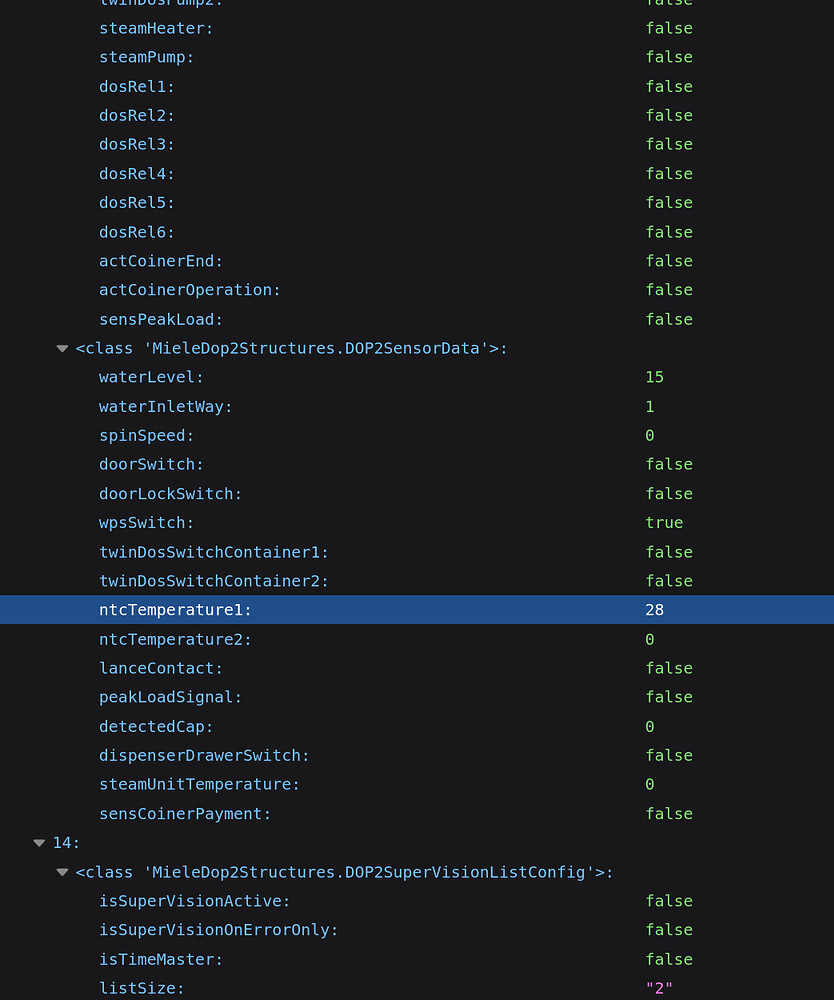

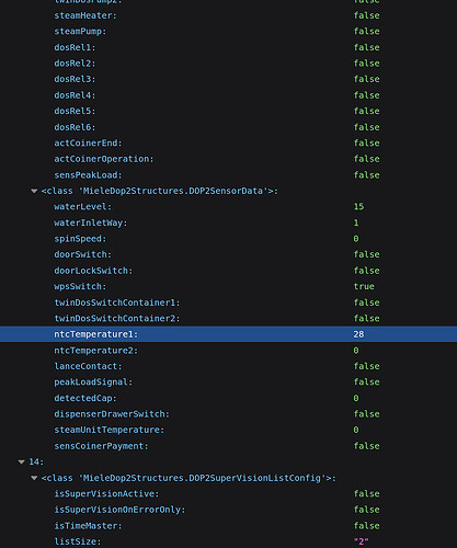

You can -- but only for DOP2 supported devices.
@tishylediathysio
Neat port!!
dop2rs was unable to parse the TwinDOS structure you were looking for, but I was able to add support for it based on Only partial device support for G6865-W · Issue #3 · tiehfood/ha-miele-at-lan · GitHub . Now you can run the dop2rs parser (cargo run -- 0540000206310000000000060001100003000104040002040500030401000510002000010700000002072ee000030500000004080000000000050500000007020000081000030001020000020200000304000009100003000102000002020000030400000a10000300010200000205000000030400000b100003000102000002020000030400000e100003000101000002010000030100000f10000300010200000201000003040000100500000011070000001205ffff001310000300010200000203000003040000161000030001020000020500000003040600171000030001020000020500000003040000181000030001020000020203000304000019100003000102000002020000030400001a100003000102000002020000030400001e100003000102000002080000000000030400001f100003000102000002080000000000030400002310000300010200000201000003040000241000030001020000020100000304000025100003000102000002050000000304000026100003000102000002050000000304000028100003000102000002020000030400002a10000300010200000205000000030400002c100003000102000002020200030419002d10000300010200000205000000030400002e100003000102000002010000030400000610002300010401000210000600010400000204000003080000000000040800000000000508000000000006080000000000031000060001020000020500000003050000000405000000050500000006040000041000060001020000020500000003050000000405000000050500000006040000051000060001020000020800000000000308000000000004080000000000050800000000000604000006100006000102000002080000000000030800000000000408000000000005080000000000060400000721000200080002020100030536b0000405000000050500780006100003000102080002026400030400000710000300010208000202000003048c0008100003000102080002022a0003048c000910000300010208000202310003048c00080002020100030536b0000405000000050500730006100003000102080002026400030400000710000300010208000202000003048c0008100003000102080002022a0003048c000910000300010208000202310003048c0008020000090200000a050000000b0400000c0100000d100003000102000002010000030400000e100003000102000002020000030400000f10000300010200000201000003040000100100001410000300010200000208000000000003040000151000030001020000020800000000000304000016100003000102000002080000000000030400001710000300010200000208000000000003040000181000030001020000020200000304000019100003000102080002010000030400001a100003000102000002010000030400001b100006000102080002020000030214000402020005020000060400001c10000300010200000205000000030400001d10000300010200000205000000030400001e10000300010200000205000000030400001f1000030001020000020500000003040000201000030001020000020300000304000021100003000102000002010000030400002210000300010200000201000003040000231000030001020000020500000003040000241000030001020000020200000304000025100003000102000002010000030400002610000300010200000201000003040000091700142f6c2f662f672f6800142f6d00000000000000000000000000000000000000000000000000000000000a0400000b0100) and you'll see all the consumables info decoded.
Perhaps we should start collecting DOP2 trees from different devices to make this less manual.
