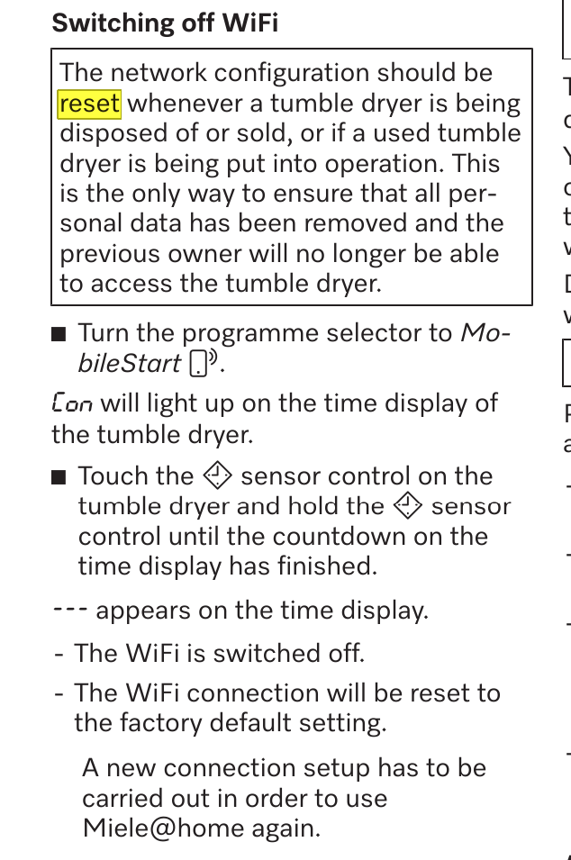

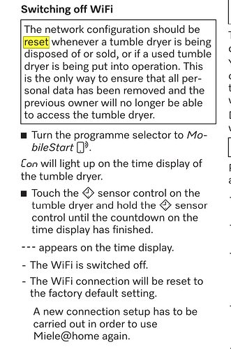

do I understand this correctly – you have previously connected this device to your WiFi and to the app. You then followed some steps on the control panel to reset it, but after completing the “reset”, it still retains the WiFi information and connects to the same WiFi?
If so, there is a problem with the reset. This would also explain why the key provisioning does not work – it still has the old key. I found the manual for your device, and the manufacturer is quite clear that a successful reset should delete the WiFi credentials. Were you following the reset sequence as described?

So from brand new out of the packaging, I connected it to the wifi only and had the provisioning issue. I’ve since connected it to the app.
Yes I’ve reset the network configuration which doesn’t appear to reset the keys.
I’ve blocked the device from the internet, reset the networking, factory reset it and it still 403’s
A device that has been provisioned will normally
broadcast its GroupID every few seconds on MDNS. So the next logical step in diagnosing this would be to record traffic to/from the device, then we can understand whether it is already provisioned. Could you record about 20 seconds or so of traffic from the device, and send me the PCAP file? Please also access the /State endpoint on the device (not on the server) and include that in the PCAP?
Also, what method did you use to connect to WiFi – my script, or WPS?

And I used your script to connect the device to Wifi
Thanks. Interesting – your device reports (in packet #6) to be provisioned with a group ID of C2DB2EC520223532. Is this the group ID you were attempting to set previously, or is this this value otherwise known to you in any way? Wondering if your device might have been a returned unit and we just haven’t figured out the correct way to clear the previous owner’s configuration.
When you do the reset process I described, does the Wi-FI configuration go away, or does nothing happen?
