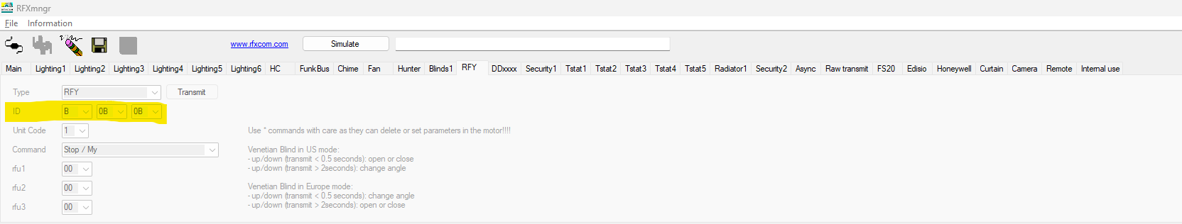

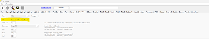

@b_weijenberg That was very helpful, thank you so much! Found out what the issue was, those Device ID’s I’d provided were taken directly from OH and were in decimal format, which was incorrect. They needed to be in Hex. So, based on 1 of the examples i provided (723723.1 Kitchen Blind 1);
723723 is B0B0B Hex
So, in RFXmngr i went to the RFY tab and entered the Hex value as the ID
When i transmitted this using RFXmngr it gave me output (cannot paste the image here, since i’m only allowed one image as a new user) which contained a HA Code, 0C1A00060B0B0B010000000000
Pasted this as me “new” device and “boom”, blind is working. Hopefully this might help someone else if they come across the problem.
