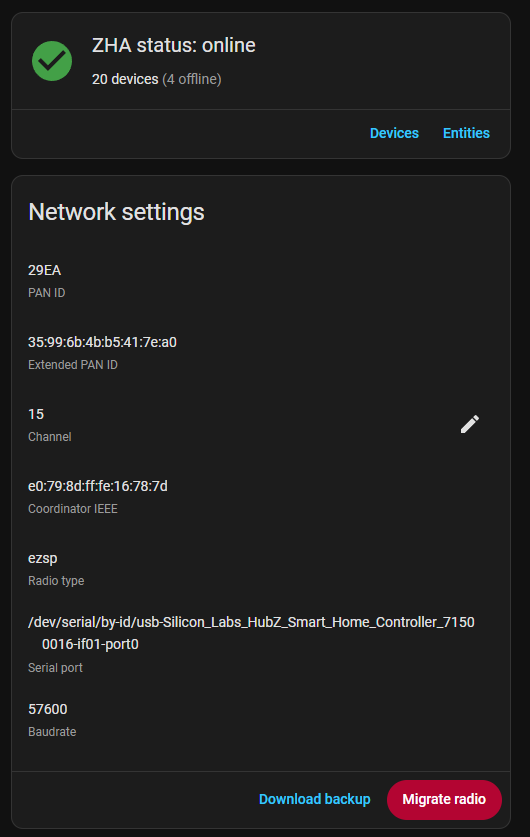

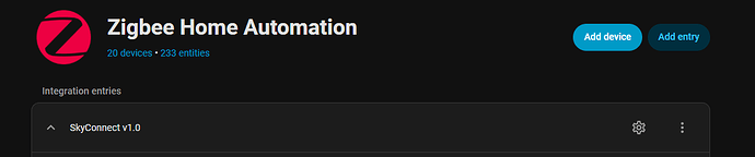

On top of this even though the ZHA show this
once inside the config this is what shows
Thjis is with the skyconnect unplugged to see if everything carried on functioning.

Looking at the Zigbee map and all the items it does not look like anything is connected to the SkyConnect but the HUSBZB-1 (as per the second picture) but I need to confirm this.
