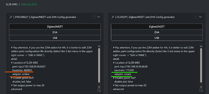

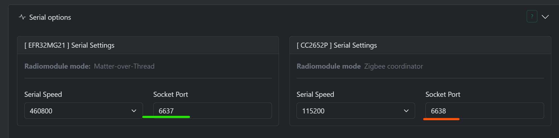

Have you set different ports and serial speeds based on the different chips?
I am running a MR2, but our setups should be similar…
