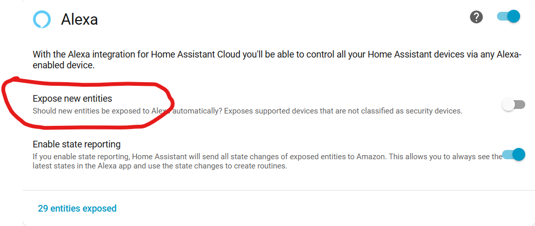

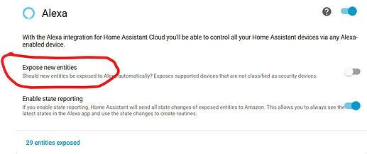

Firstly, I HIGHLY recommend disabling the “Expose new entities” in Alexa! I wound up with so many entries in Alexa that I did not want. Just add what you want as you go along.
