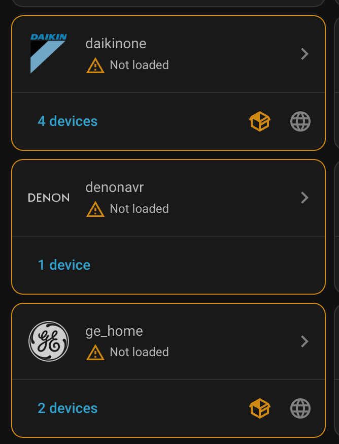

I am moving from an Intel mac mini using virtualbox and HAOS to a Apple Silicon virtualbox using arm.
I took a full backup from old system, loaded to new, but now some of my addons are failing to load. Some are from HACS, but some are built in.
Any ideas? So far, i have tried to install the missing components with pip in the command line, running ha supervisor repair, and googled like crazy. Tried removing and readding the broken components, but for example the apple TV one i cant add it after.
