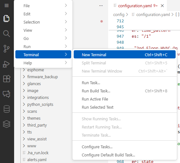

BUT…when I “copy” the file using Studio Code Server and then go to the Terminal it says…“no such file or directory”.
If I do an ls in /tmp all is see is tmux-0, but if I look at tmp in the Explorer section of Studio Code Server I see my two files, plus a bunch of vs code stuff. I’m hopelessly confused.

You know the terminal command is built in to Studio Code Server, right? Are you using that terminal?
I didn’t…but that helped…migration still didn’t work, but I did get the files copied and ran the script fine.
