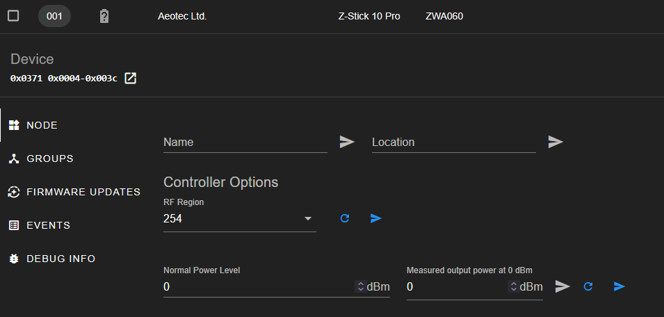

I’ve recently bough an Aeotec Zwave g10 dongle and wanted to migrate my actually working network to it.
Sadly, even if the restore looks to be OK, my nodes are stuck at “protocol info”.

2026-07-30 23:04:27.640 CNTRLR The controller is using RF region Unknown
2026-07-30 23:04:27.640 CNTRLR Querying configured powerlevel…
2026-07-30 23:04:27.646 CNTRLR The powerlevel is 0 dBm (0 dBm calibration)
2026-07-30 23:04:27.647 CNTRLR Querying configured max. Long Range powerlevel…
2026-07-30 23:04:27.651 CNTRLR The max. LR powerlevel is 0.0 dBm
2026-07-30 23:04:27.652 CNTRLR Current RF region (Unknown) differs from desired region (Europe (Long Range)),
configuring it…
2026-07-30 23:04:27.657 CNTRLR Changing the RF region failed!

What have i done?
Updated Z-stick G5 to FW: v1.2 - SDK: v6.81.6
G10 stick is already on V7.23.2
Followed this guide:
Using the Z-wave JS UI (V7.4.0)
Make backup of NVM from g5 key - file is around 256KB
Swap the serial port to new key
Restore backup successfully
Nodes stuck at protocol infos (even after many restarts)
Fun (or not) fact:
if i backup the new “restored” key, the file is only 40KB and cant be restored back.
Region looks strange to me:
What am i doing wrong?
