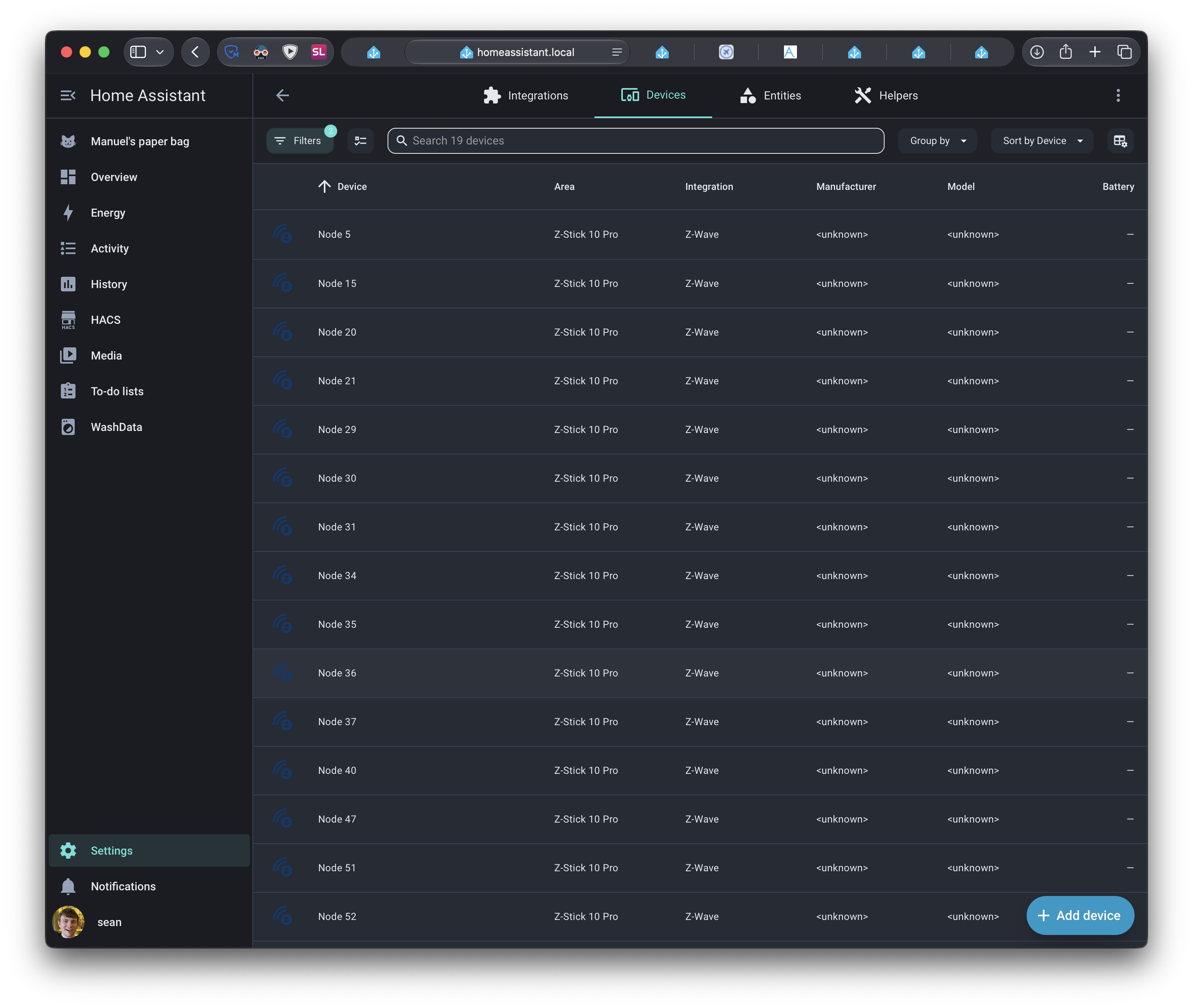

I have an old zwave 500 stick I am finally replacing with a zstick 10 pro with an 800 chip. I imported the backup into it but it throws an error and shows everything and numbered nodes that never wake up and do anything so I’m just going to just nuke them all and start over.
the zwave switches/dimmers, including a zw3005, and a combo fire and CO detector are refusing to fully reset and exclude themselves. the basement zcombo is a newer model thats fairly cooperative but the living room is just refusing to join anything. the dimmer I tried power cycling and the rapid 3 top 3 bottom taps but it just will not reset.

the throws a error thing I fixed by completely removing zwaveJS and reinstalling it. the numbered nodes are composed of wired and battery devices. waking them up changes nothing
nothing want to talk to this new stick. it cant even identify nodes.
