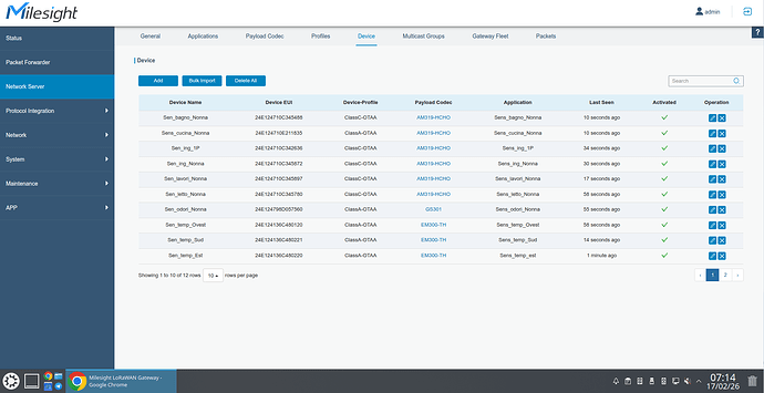

The sensors seem not firing at the same time and the UG65 tells (during the problem) that it can see all the sensors :
So, it seems that there aren’t problems on the path sensors > LoraWan protocol > UG65 gateway.
