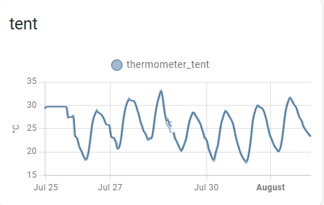

Where does statistical graph produce this
chart_type: line
period: hour
type: statistics-graph
entities:
  - sensor.thermometer_tent
stat_types:
  - mean
  - min
  - max
title: tent
The same sensor. And when i go to history i also see the information.

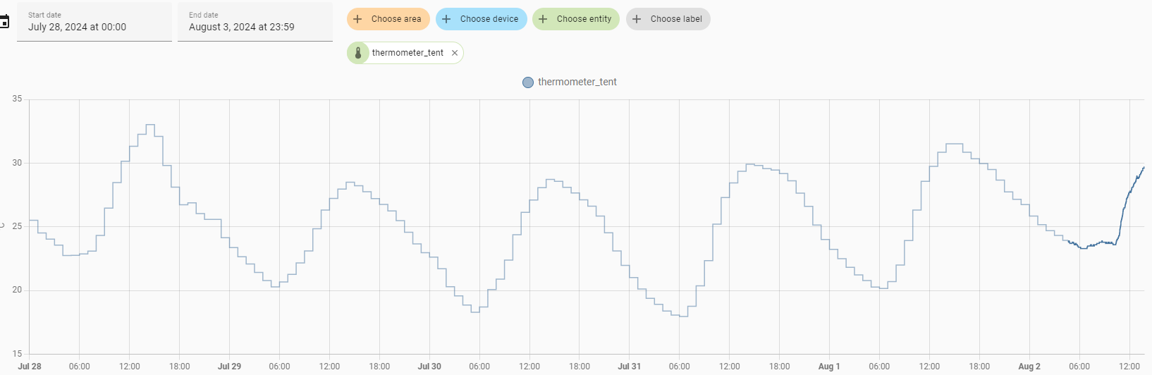

Here is the picture of history of same sensor.

I would suggest to post a screenshot of history-graph with same hours-to-show.

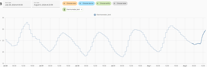

yes here is the history graph there are values.
thank you
sensor was made week ago
You are showing a History view which contains LTS before ~04:00 , August 2.
Means - you have NO history before that moment.
And that is why mini-graph shows a flatline (just a guess since you have not mentioned at what time that mini-graph stops showing flatline).
