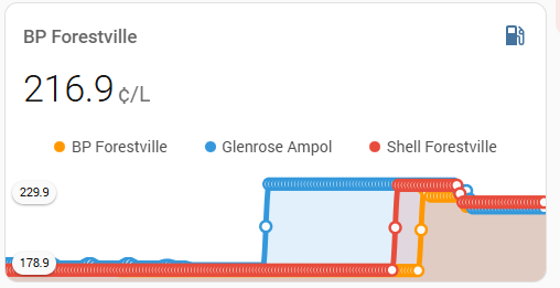

I am using the mini-graph-card and am storing the fuel (gas for our American friends) prices and tracking this. The card itself shows 3 stations prices but the first entity in the YAML is what is always displayed. Is there any way to have the entity listed with the lowest price in the entity name field? TIA for any help.
P.S. looking to avoid overly complex YAML if it can be avoided.

type: custom:mini-graph-card
entities:
  - entity: sensor.bp_forestville_p95
    name: BP Forestville
  - entity: sensor.eg_ampol_glenrose_p95
  - entity: sensor.shell_reddy_express_forestville_p95
    name: Shell Forestville
show:
  labels: true
  labels_secondary: true
hours_to_show: 336
You can create a Min/Max sensor:
sensor:
  - platform: min_max
    type: min
    entity_ids:
      - sensor.bp_forestville_p95
      - sensor.eg_ampol_glenrose_p95
      - sensor.shell_reddy_express_forestville_p95
and use it as a 4th entity like this:
entities:
  - entity: sensor.min_p95
    show_graph: false
    show_state: false
    show_state: false
    show_state: false
show:
  labels: true
hours_to_show: 336
If you want to display the name of the gas station with the minimum price at the top, you can also create a text sensor that defines the name and include it as an 5th entity.
