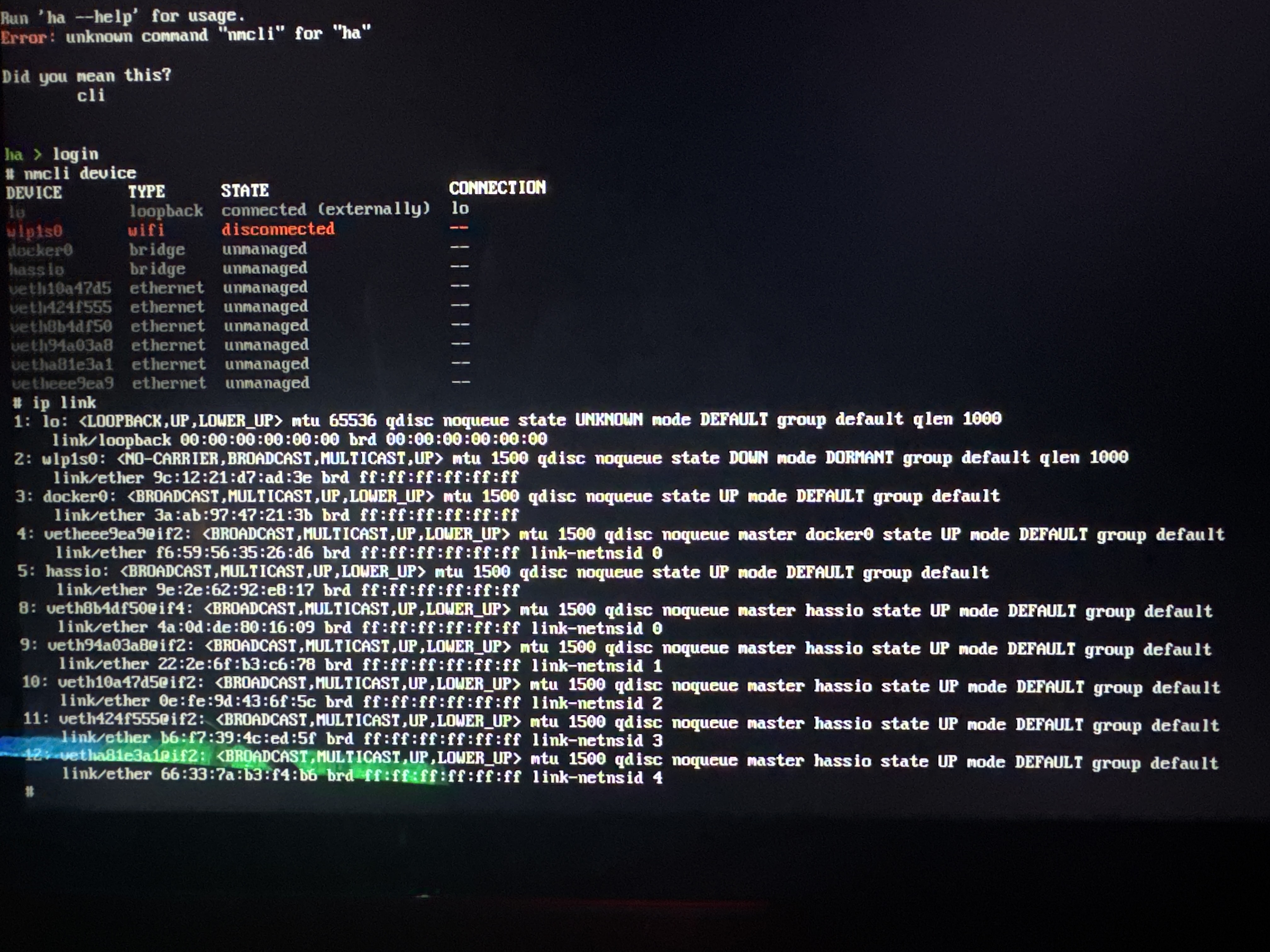

I too, bought a GMKtech G10 and had the exact same problem. I did notice that the wifi adapter is found. I added the wifi credentials, and I was able to get it to work, but not wired.
I did the following:
After the boot screen for HAOS
Ran
network info
Only the wifi device was showing. No wired
Ran
login
Confirm the device is there
nmcli device show
Executed this
nmcli device wifi rescan
Next
nmcli device wifi list
Ran this command to add wifi to the abapter
nmcli device wifi connect "YOUR_SSID" password "YOUR_WIFI_PASSWORD"
Then exit
exit
Confirmed IP
network info
Reboot
host reboot
Confirm the IP again to make sure it has been saved.
network info
Now you should be able to log in to
http://homeassistant.local:8123/
