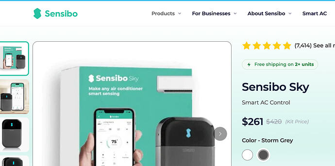

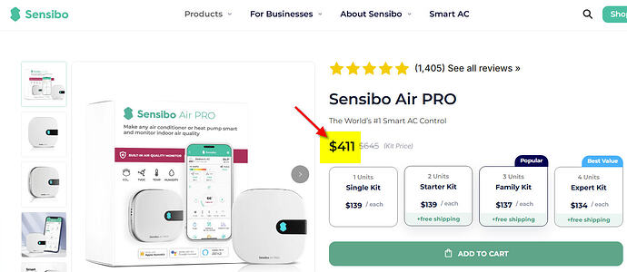

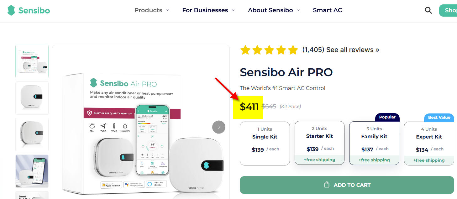

$400 for a cloud-based controller? ARE YOU FKN KIDDING ME?

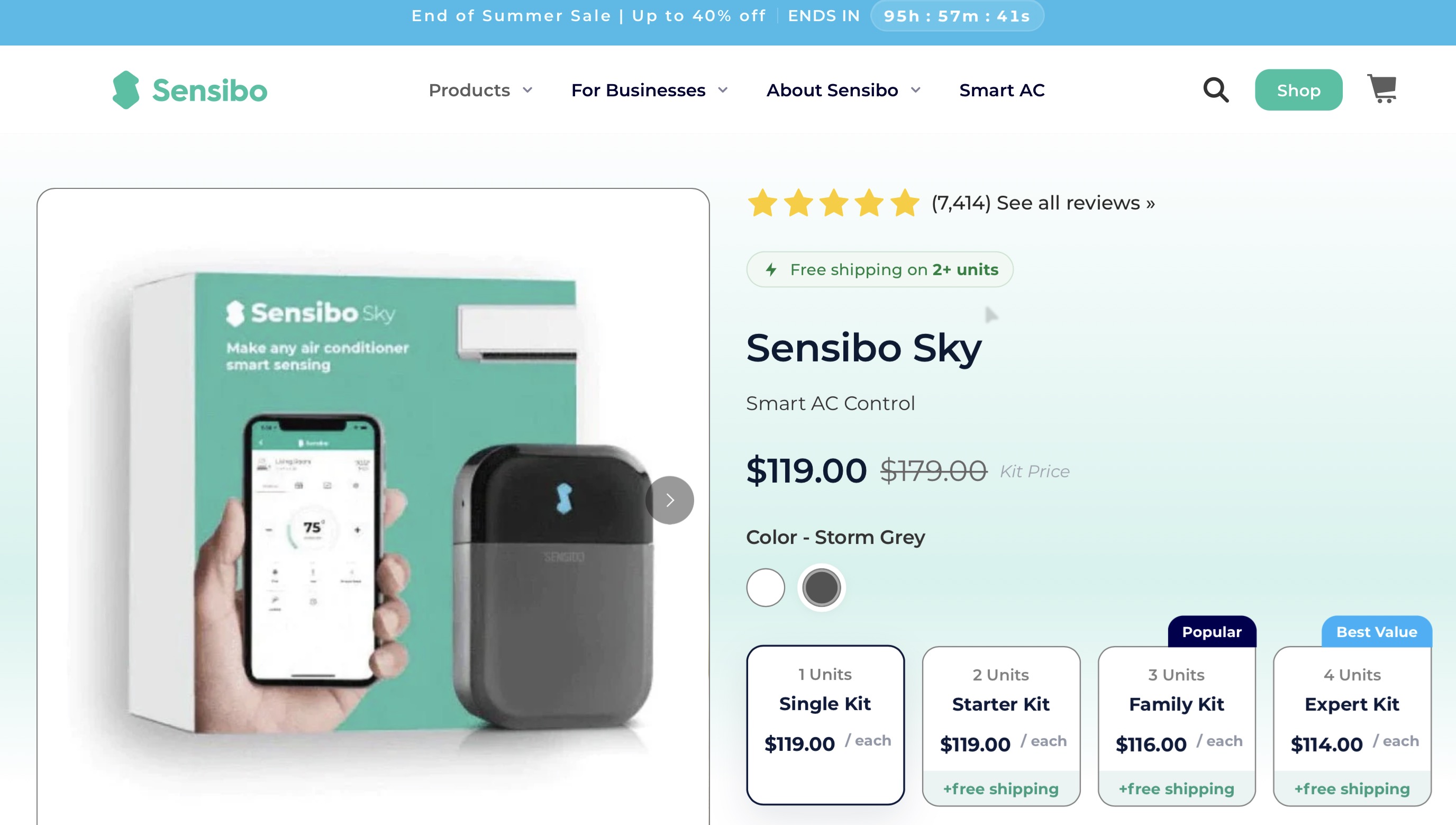

All I saw was $411. I didn’t look further that it was a kit of three units.
But $119 is still $100 overpriced for a cloud device.

I think different people see different prices. However, looking at it, it does not return state. It looks like it replicates an IR remote - and there are lots of cheaper devices that can do this (I have a few). The Faikout reads the state directly from the unit, so you can actually tell what the unit is doing at any given point.
With the Sensibo, if someone turned off the device with the remote, Home Assistant would be unaware. With the Faikin, when someone turns off one of our units with the remote, Home Assistant is aware of the change.
