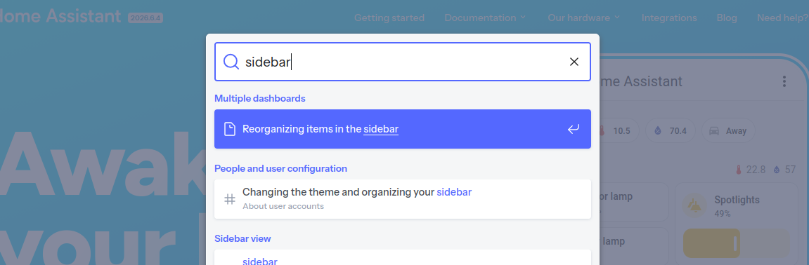

Please clarify what you mean by "main UI"...
If you mean the sidebar, see Reorganizing Items in the Sidebar, which can be found in the docs by searching for "sidebar":
