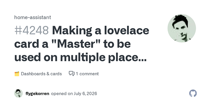

Also, I use the card in multiple places, different dashboards depending on device and so on, so I have asked for a feature request to make certain cards as "Master" so we can link and place shortcuts to them from other places. This way you only need to update the "Master" card to let it replicate on all your places
