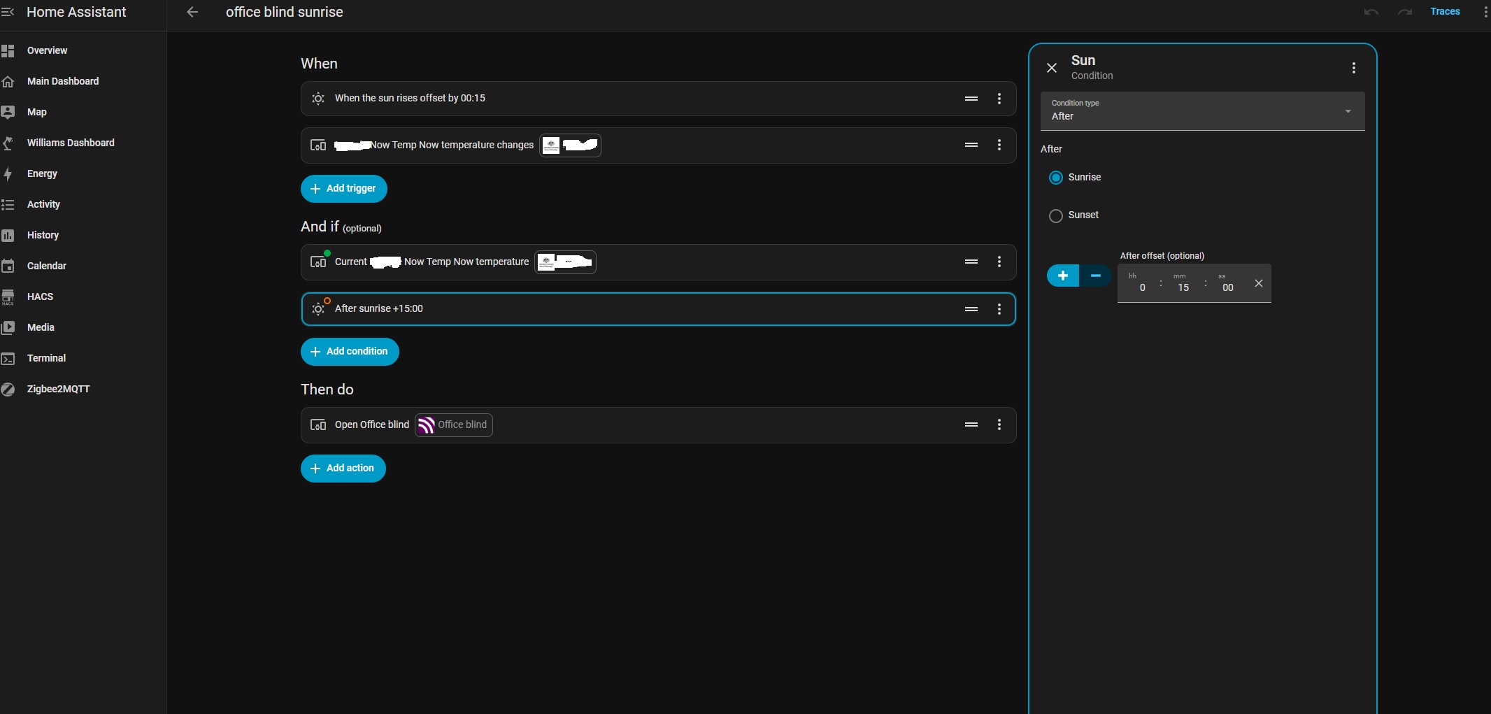

A few of my blinds decided 10PM was a good time to run the sunrise automation which has a temperature requirement, and time offset after sunrise. The temperature did fall and rise above 5, but time?! In the trace this morning I see 15 minutes is requested, but 15 hours shows in the automation. What !?

alias: office blind sunrise
description: ""
triggers:
  - trigger: sun
    event: sunrise
    offset: "00:15"
  - type: temperature
    device_id: 18aa9e5f82a5b03f7fa86fb4d35c0d35
    entity_id: 8d18cce688d543e02a9ad7b64ebf4f8f
    domain: sensor
    trigger: device
    above: 5
conditions:
  - type: is_temperature
    condition: device
    domain: sensor
    above: 5
  - condition: sun
    after: sunrise
    after_offset:
      hours: 1
      minutes: 0
      seconds: 0
actions:
  - device_id: d882ba5294e8ce498e8d1766a283973e
    domain: cover
    entity_id: 0d335f9cbe6d0fea7e3260892e64333b
    type: open
mode: single

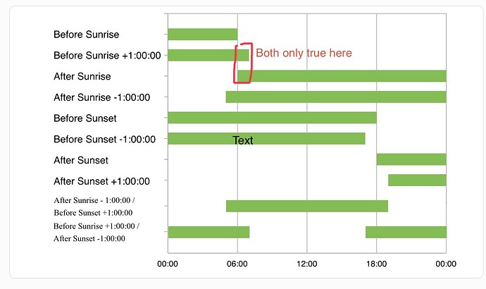

Because as karwosts said your conditions allow it to happen. Please review the operation of the sun condition here: Conditions - Home Assistant
You will need two seperate sun conditions to define a time window from sunrise to sunrise + 1hr.
conditions:
  - condition: sun
    after: sunrise
  - condition: sun
    before: sunrise
    before_offset: "+01:00:00"
