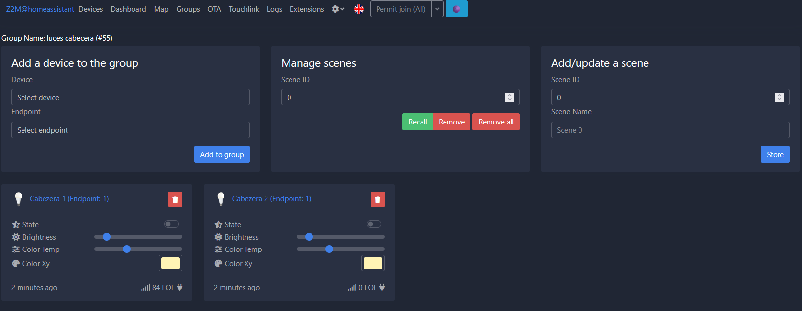

if you are using Zigbee2Mqtt theres a seccion to doit

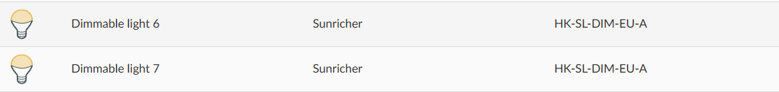

What manufacturer and model are we working with?
@WarLion suggestion may still be in play…
i believe those are Zigbee are you using z2m or zha?
on z2m just add both as a group

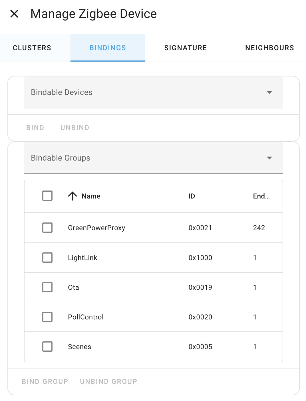

on ZHA you can use this method
if you are using a smart dimmer just change the action to the new entity
