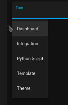

HACS does not have Apps nor Add-ons at all. It has these:
