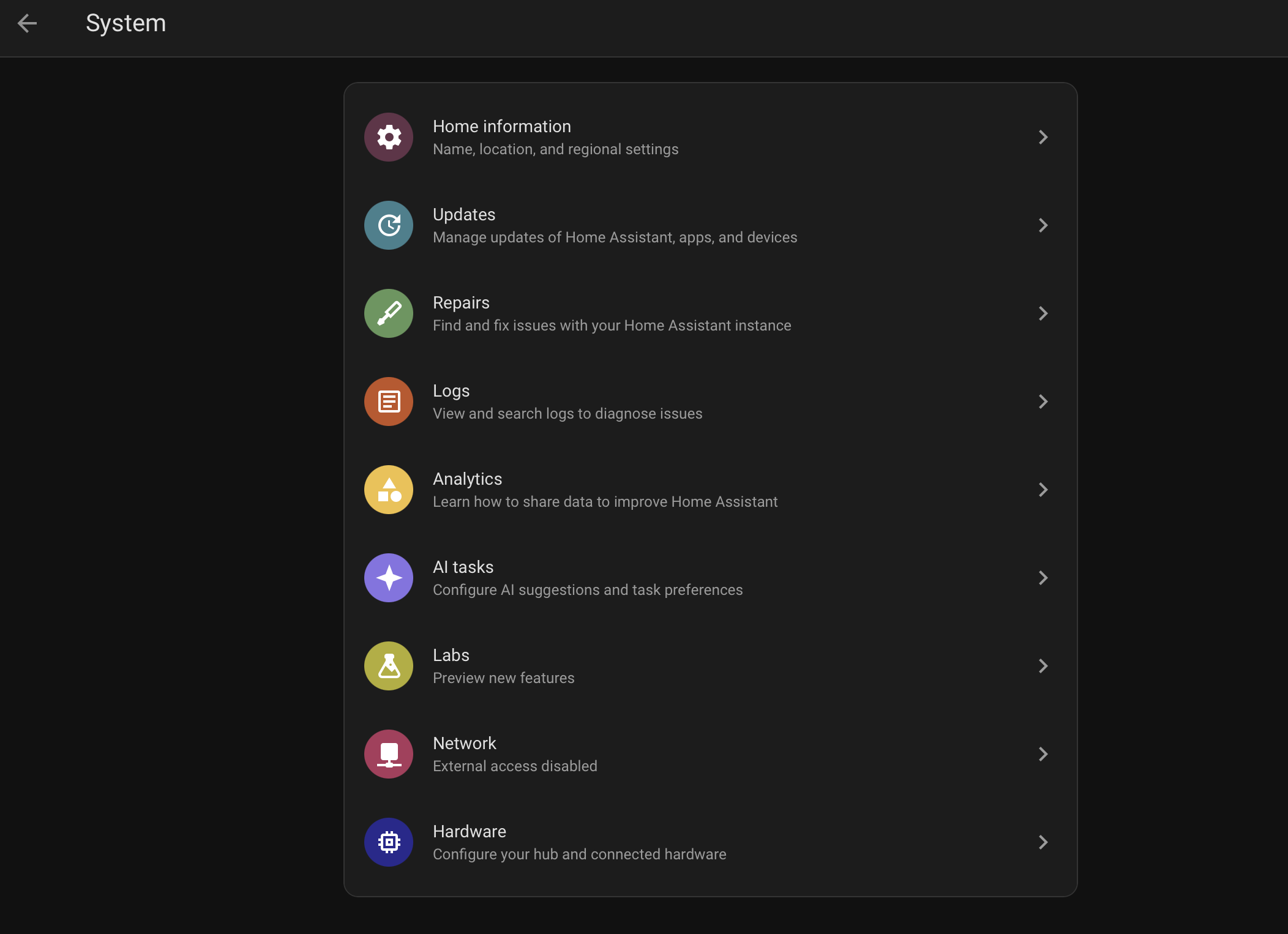

How do I enable the App Store in settings? I am trying to install Hacs from a repository and can’t get the repository to load without a place to put it. Also, how do I enable supervisor mode?

I was able to get to the apps page with the link you sent, but I can’t install any repositories. When I use the Github link I get a message that says:‘StoreManager.reload’ blocked from execution, supervisor needs to be updated first. When I try to update the supervisor it fails.
Please provide information on your install process/type.

Thanks all. I got it figured out late last night. For some reason the Home Assistant Green installed the container version when I set it up. I reinstalled the OS and everything is working as it should now. For some reason, the authentication process is failing when I try to get Wyze API keys to work. I’ll keep working on that.
