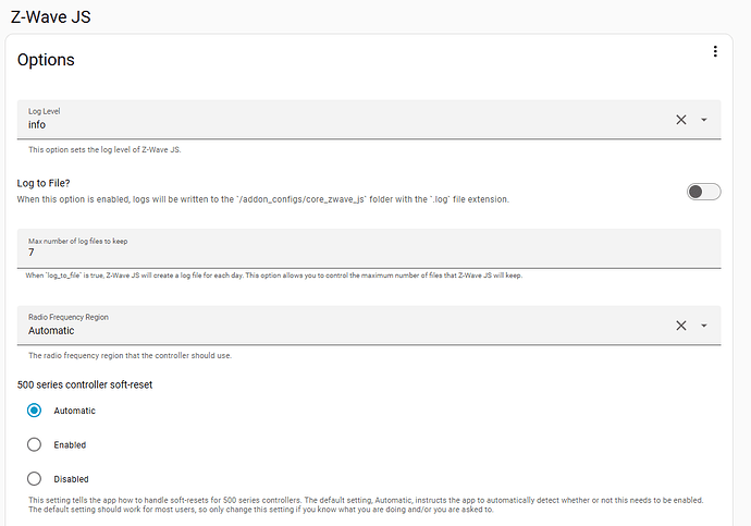

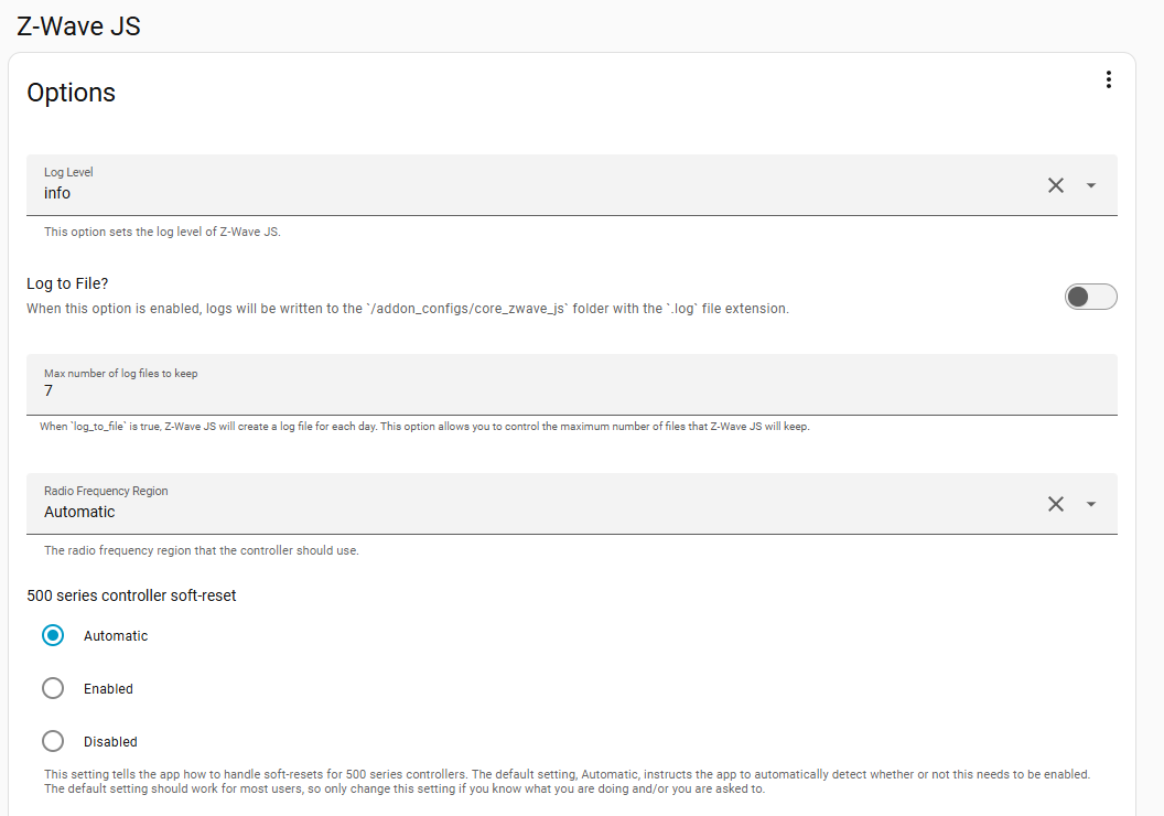

All good, obviously I need to tell the app where the z-wave stick is. The problem is there is no option for this in the configuration tab of the app. Am I missing something? The Z-Wave JS UI app works fine since it sets the serial path within the web UI. My system and stick are working fine, home assistant sees the stick in the hardware info, the z-wave js ui can see it within its own settings and comes up fine, it's just that the official app seems to have no configuration setting for it.

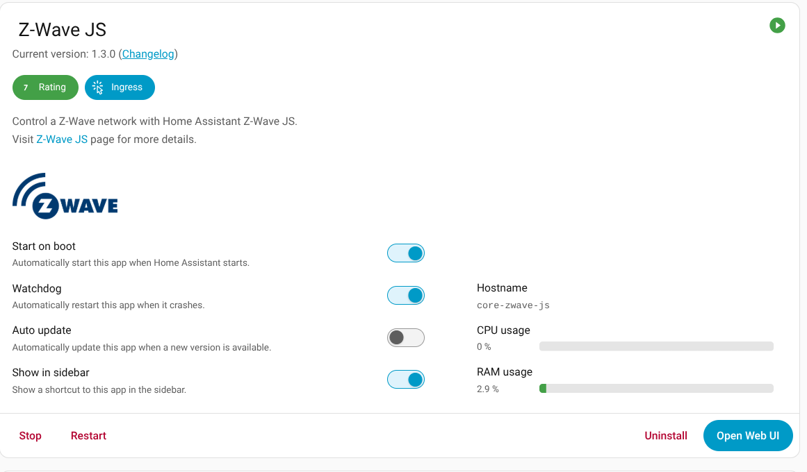

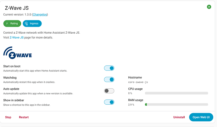

When I try to open the Web UI I get this.
It appears to flash several times as it's likely restarting itself in the background.

Using my own knowledge and a web search, it's obvious that the app needs to know where the USB Z-Wave stick is, but there is no option for this on my fresh install.

I'm completely noobie to Home Assistant, but here what fixed the same problem on my setup:
  1. Settings -> Apps -> Z-Wave JS
  2. Go to Configuration tab
  3. Click the three dots (context?) menu, choose "Edit in YAML"
  4. Add the line device: /dev/ttyUSB0 (The device name might be something else, e.g. ttyUSB1 etc., depending on what other USB-UART devices you have on your system)
  5. Save
  6. Start the App.
Hope it works.
