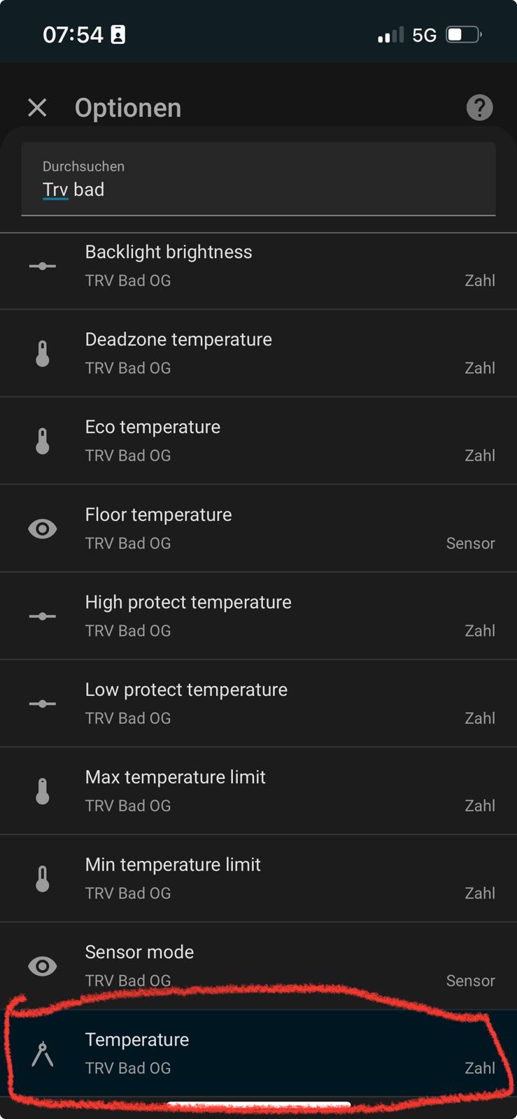

maybe some has an idea how to solve the issue, that the MOES Tuya ZigBee Smart Knob Thermostat Star Ring Serie doesnt provide the current local temp… or maybe it does and i am not able to find?

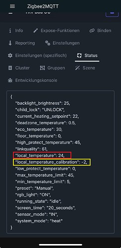

The thing is, in Z2M i can see those two values.

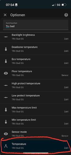

e.g. if i want to access the local temperature for a helper, i cant it.
The value in the screenshot is not called correct.
This value ist the “local_temperature_calibration” val.
And the strange thing is, that this calibration val sometimes changes it self.
Does anyone has an idea how to access the local temp val?
