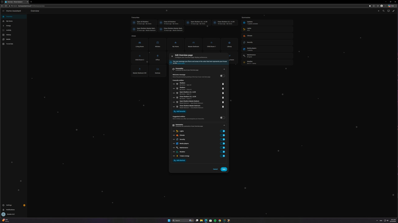

Few days ago I have integrate all devices into HA and start exploring. I want to add some features like home overlay map, some interactive dashboard which I have found on youtube, but /i am missing additional options on menu bar. While I follow instructions, once I clock on PEN in Dashobard, I am not getting any additional options like on the wideo tutorial.

Tell us what video you are trying to follow and what options you are expecting to see.
But chances are if you are following a video over 6 months old will be leading in a direction no longer available. HA moves on fast and things change a lot.

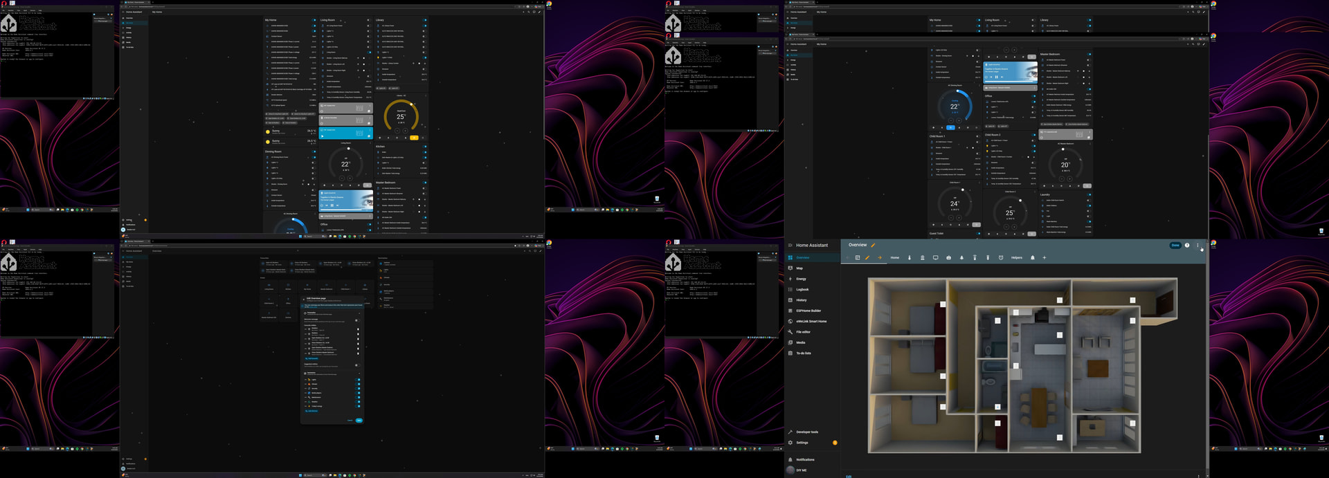

Oh and nothing can be seen in that picture you posted, the resolution is far too small.

As being new to forum, I am not able to upload more than one picture. Picture has been imported on postimages in 4k - 8mpx, but forum reduces it

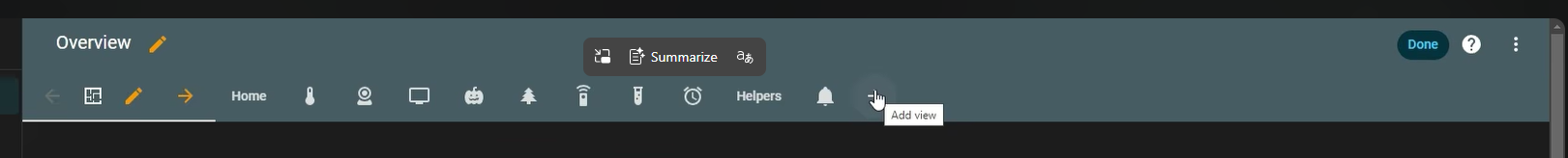

So you still haven't told us what you are expecting to see, but adding cards has changed in the last update of HA. So as suggested following this video will not go as expected. If you want to get to the selecting cards panel in the video, select add card and then in the right hand panel you will see "browse all cards" click that.
I am only guessing this is what you want to see,

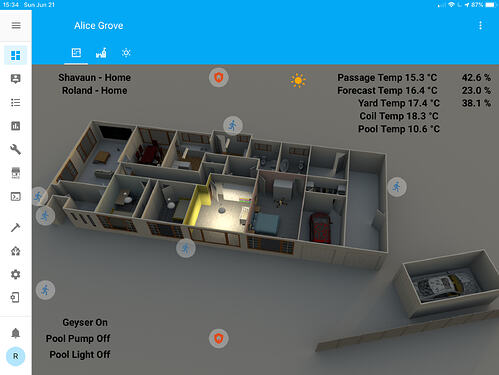

Do you mean something like this?

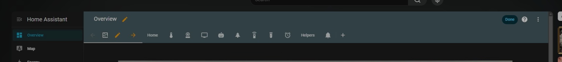

For now I want to create map of my home. By following youtube tutorial, link above I am not able to see options in my menu bar so I can move on forward. I have different, post no 5, while on youtube tutorial has more option. How to get that options so I can import picture and create home.

This is menu what I have.Dashboard, three dots right up corner
Did you create a new dashboard? The overview dashboard will not allow you to do this as its auto generated. This again has changed in the last 6 months or so, which explains why I suggest reading the docs.

I have done it but I didn't have it that option. I guess, I am not sure. Now I have it. Thanks

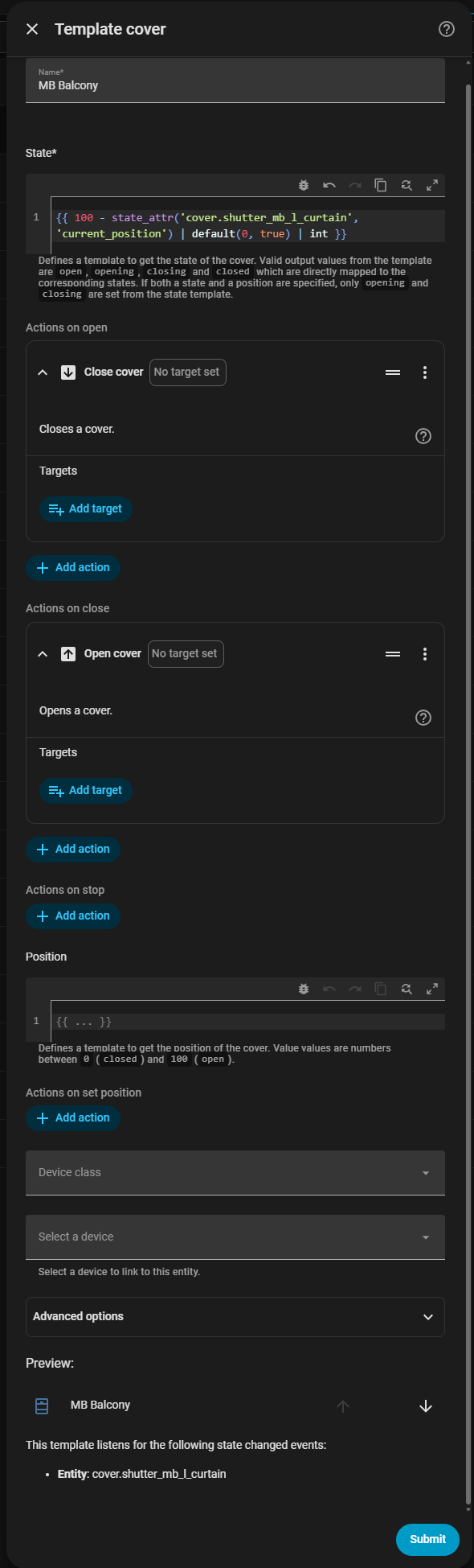

I have one more problem.
I have doors shutter. All of them are showing open if closed and opposite.
I have follow instructions - created Template Cover Helper, changed to both of the options
{{ 100 - state_attr('cover.shutter_mb_l_curtain', 'current_position') | default(0, true) | int }}
and
{{ 100 - state_attr('cover.shutter_mb_balcony_curtain', 'current_position') | int }} plus state open to close, and close to open, but no luck. When I give open command, it is closing
I'd suggest creating a new thread for your template cover issue.
Or just flip the open/close wires on your door shutters and call it a day.
