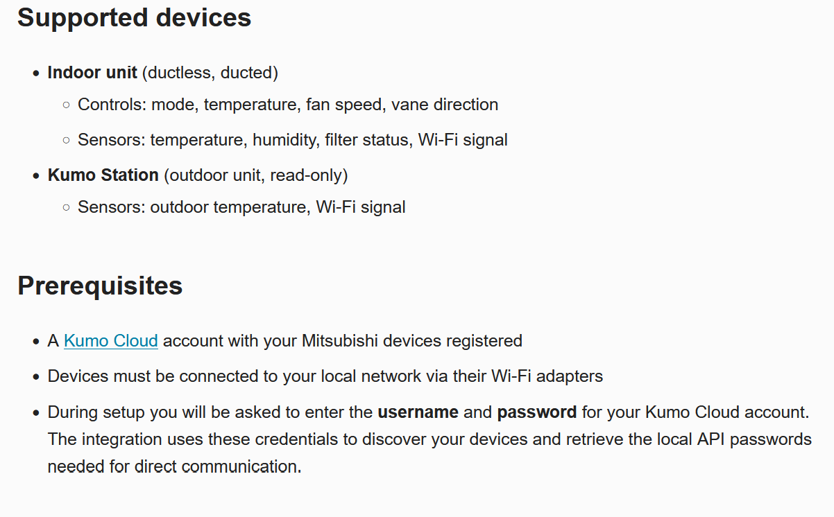

Hi David, is all this correct:
Yes, all of this is correct!
