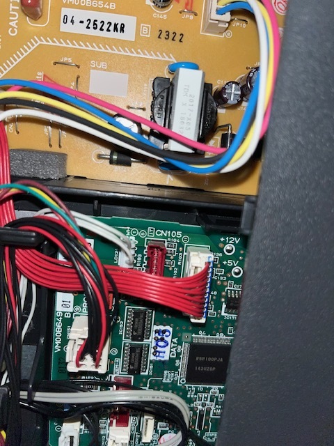

I have the MSZ-LN series air conditioner. According to ProArt, the Wi-Fi module remains installed on the CN110 port and the ClimateControl is installed on the CN105 port.
The CN105 port is located on the right side of the air conditioner behind the white cover. The exact location can be found in the manual.
So I was hoping this method would also apply to you and that you could use photos to explain how I should proceed.
Just installed one to my parents msz-ln35vg2w, though this one GitHub - echavet/MitsubishiCN105ESPHome: ESPHome firmware inspired by GeoffDavis’s esphome-mitsubishiheatpump, directly integrating the SwiCago library within its codebase. with esp32 s3n16 board.
After the board is configured ant the tail plug is welded to right pins, its was just 3 screws, and the platic cover comes off, then just one screw and the last metal cover comes off. The cn105 connector was clearly marked and free, and the melcloud had it own plug. So then is just plugged the board in and put it all back together. After that the homeassitant found it, and i jus added it to the console.

Yes, that is how mine works. You need to do a fairly significant dis-assembly of the unit, but it stays mounted to the wall of course. Remove vanes, remove plastic shroud around most of the unit. Easy to plug in after that. Be sure to power down system first.
