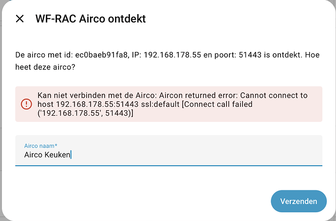

Hi all, I get this message when I want to integrate my airco. What can I do?

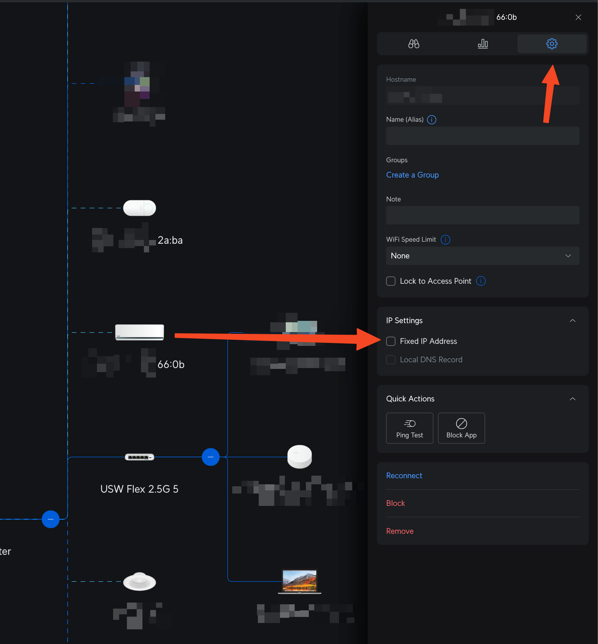

I have 2 aircons connected, and both were working perfectly. I have a UniFi router that I set the IP addresses of the aircons to fixed to ensure they don’t drop off HA due to the IP changing.
After a week or so both units showed as disconnected in HA and I wasn’t able to ping them. Deleting the devices from HA and trying to re-add them showed the following error: Could not connect with the Airco: Aircon returned error: Cannot connect to host 10.0.0.182:51443 ssl:default [Connect call failed (‘10.0.0.182’, 51443)]. The odd thing was that the units were showing as “Discovered” on the Devices and Services dashboard of HA.
The only thing I found that worked was unchecking the fixed IP address option in the UniFi settings.
At this stage I believe this to be an issue with the settings in my UniFi router and not the aircons, but I haven’t done a deep dive into it, and for now I’m happy just to have everything working again.
