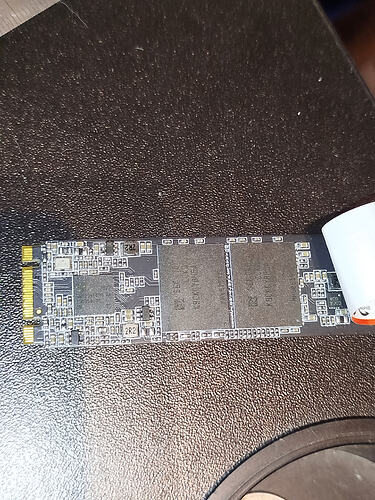

the internal SSD.
I would check that. That is if it came with the pc. It may just be a emmc in disguise.

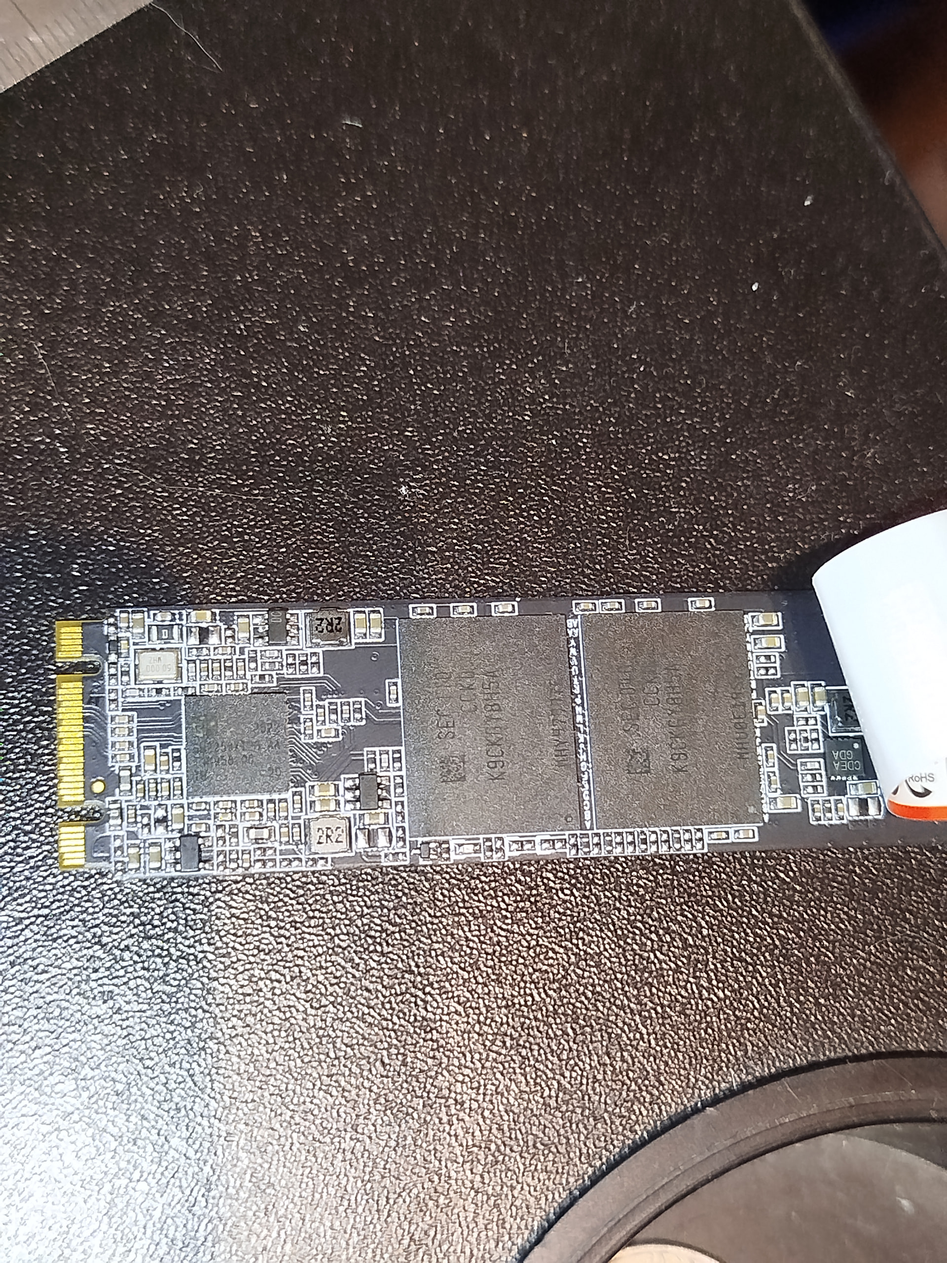

I did a search on the nand chip "k9ckgy8h5a".
It comes up as a Samsung chip.
I highly doubt that. As this is a no named brand.
Have a look at this drive https://www.aliexpress.com/i/3256809755030853.html .
It's and ssd format but has the same chips as the m.2 in the pc.
