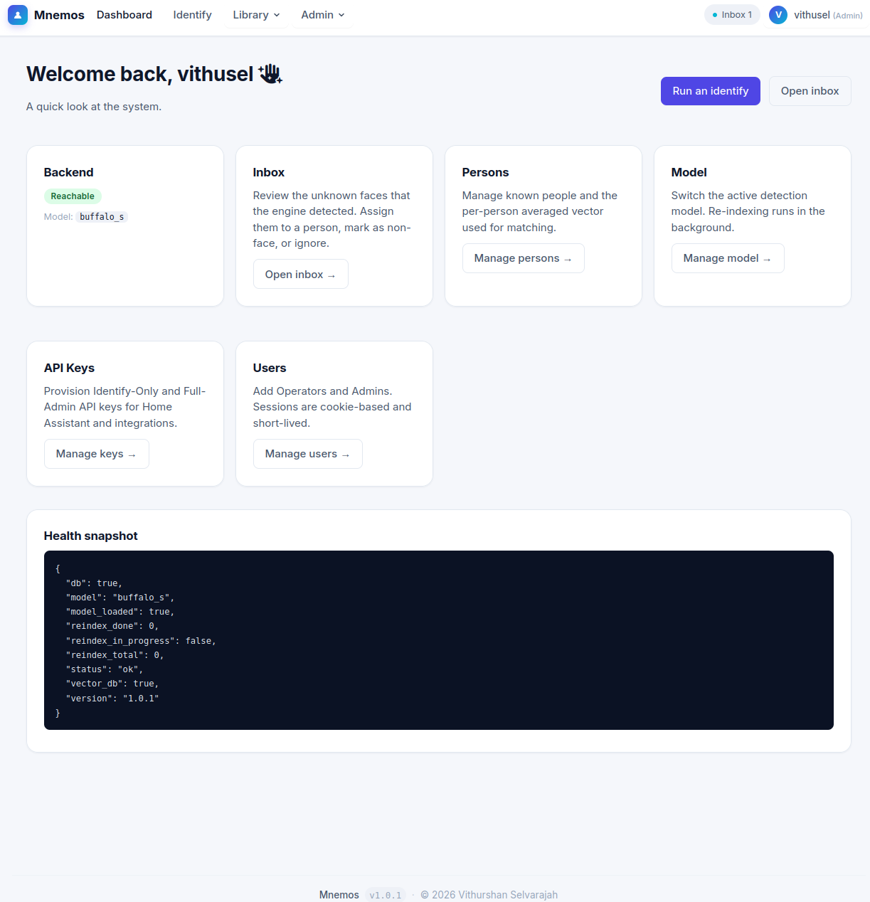

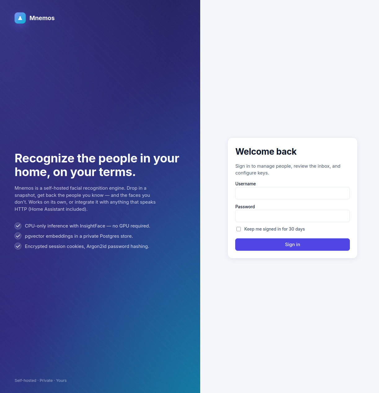

What is Mnemos?
Mnemos is a lightweight, locally run application that operates via API endpoints. It is split into two main parts:

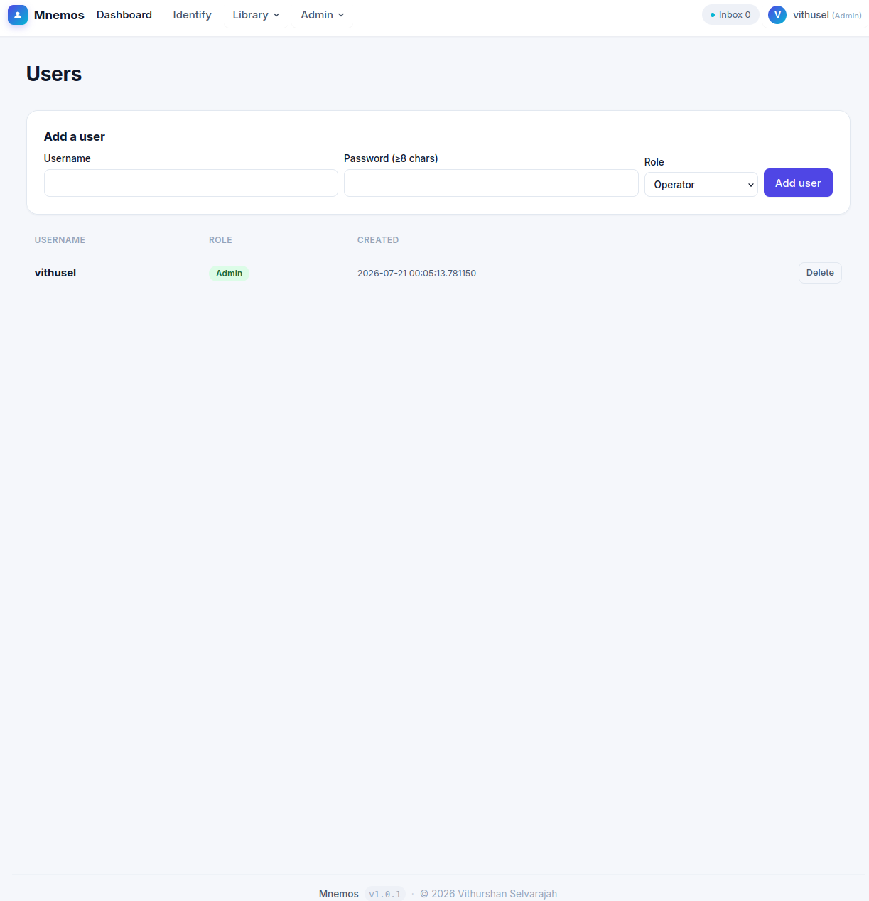

  • Frontend: A clean interface where all user and person management takes place.
  • Backend: Left free to handle all the heavy image processing and lifting.
Instead of requiring a 24/7 video stream, Home Assistant is in charge of sending snapshot images to its /identify endpoint. The endpoint will perform analysis and return a list of names & confidence. In the event the person is unknown. They are automatically added to the user interface for tagging later.

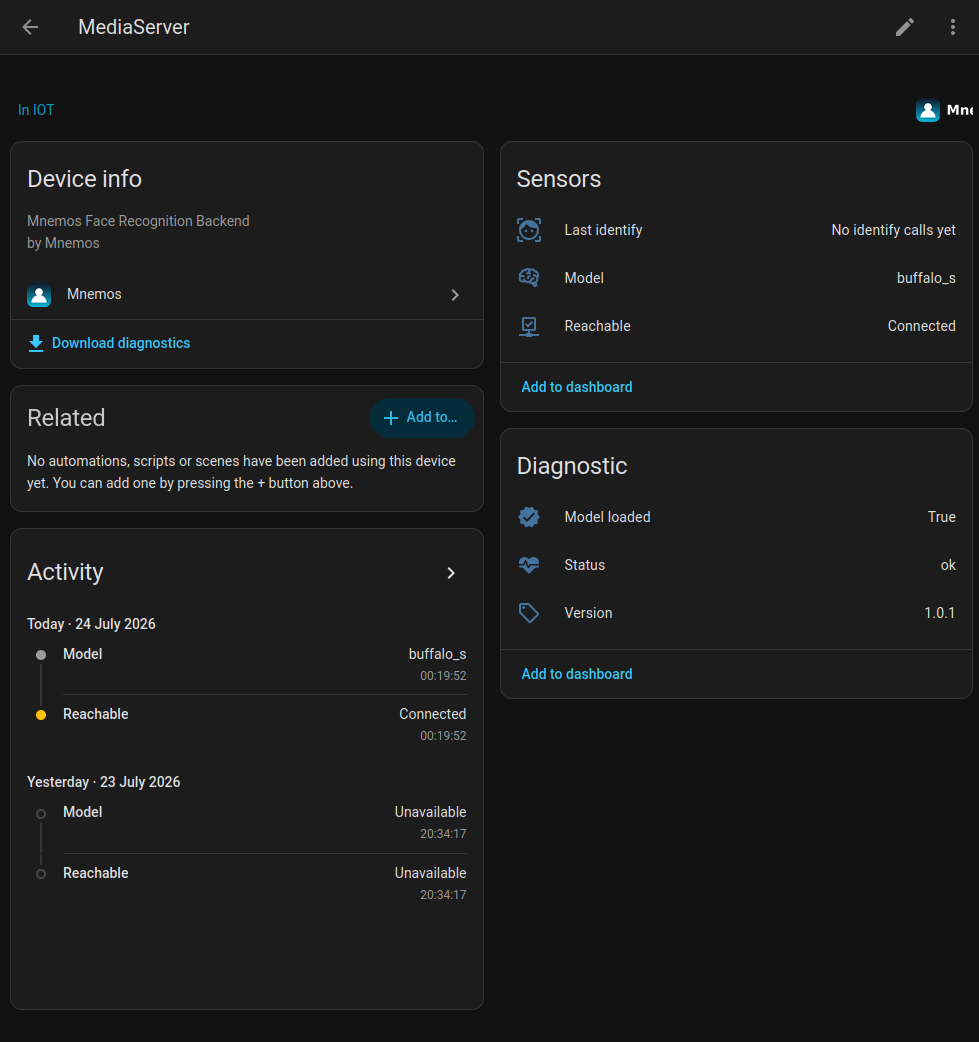

Home Assistant Integration
To make setting it up painless, I created a companion HACS integration: Mnemos-HA.
It includes state sensors and an action you can use directly in your Home Assistant automation’s to send snapshots from your cameras whenever motion is detected. The action will respond back with identites in standard JSON format allowing easy parsing within Home Assistant.
