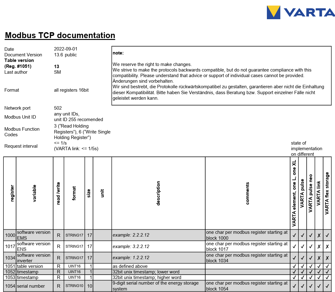

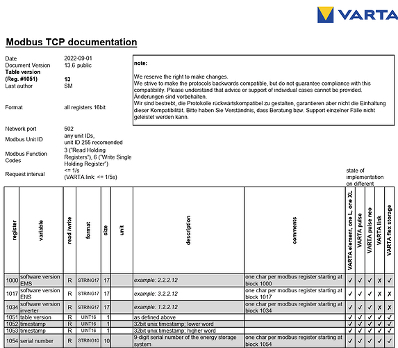

Trying to use a very simple configuration to just read the serial number of the battery:
I added the following to the configuration.yaml
modbus:
type: tcp
host: 192.168.178.97 # replace with your ip of the your varta
port: 502
delay: 1
timeout: 3
message_wait_milliseconds: 250
sensors:
### Serial Number
- name: mb_varta_serial
slave: 1
address: 1054
count: 10
data_type: string
precision: 0
scale: 1
