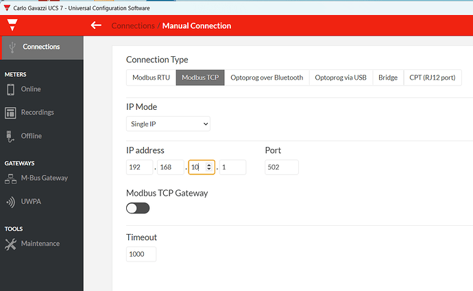

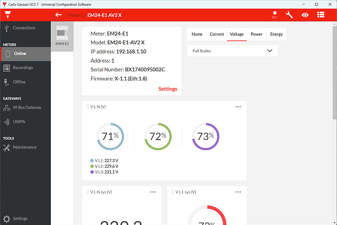

The connection works in the Carlo Gavazzi UCS7 configuration software:

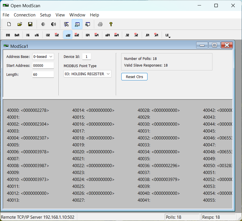

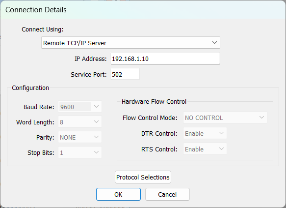

I can also read the registers with Open Mod Scan:
