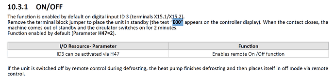

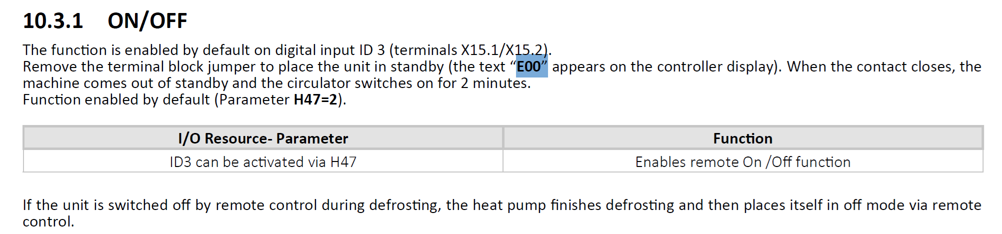

Hi guys, back again. My setup seems to be working fine with my yaml config. In my area we often get power outages in bad weather conditions and the only issue I’m having is in case of power outage the heat pump shows E00 and unless I disconnect my waveshare module, reconnect the original Hi-T controller, wait for Hi-T software boot and error reset on heatpump, then disconnect controller and reconnect waveshare module the error will not reset. I event tried to setup various automations to set the control registers and change their status, but nothing seems to work unless I do the procedure I just described. Since I’m not interested in my original Hi-T controller what can I do to prevent this from happening? have you also experienced the same issue?
I’m not sure i understand your problem. E00 is not an actual error. it just means that the heatpump is off and waiting for an external device to turn it on by closing the x15 contact
Yes, I realised my mistake this afternoon analysing the heat pump’s manual, I’ve now put a jumper between x15.1 and x15.2 which solved my problem and enabled remote control. Didn’t need it with the original controller because it closed it digitally. Also created an automation to detect when register 7201 is 0 to automatically restore it to 3 so that in case of power outage it restores control automatically.
Thanks!
