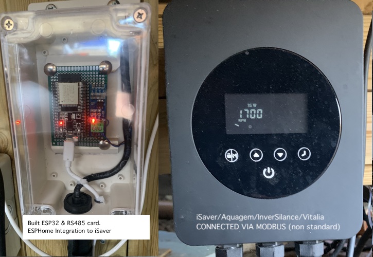

Hello, I am currently trying to create a module that will connect to my iSaver+ Pool Pump inverter and allow me to read the current state of the pool pump from the unit.
Pool pump regulator manual: [Manual (page 8) ]
I have set up an ESP-32 with a TTL to RS485 converter and have managed to send a custom command and see a response from the unit.
The iSaver+ uses non-standard Modbus protocol commands which are detailed in this document here: RS485 Protocol.
The issue I have is that when receviing the standard response code from the unit ESP Home does not seem to receive the last byte of data which means the CRC check fails and I cannot read the response.
You can see in the logs here that only 8 bytes of data are received whereas the protocal calls for a response of 9 bytes. Here are the expected frames for query and response.
The query is working fine and the unit accepts the 8 byte custom command i can send.
You can see in the logs below that only 8 bytes are received as opposed to the 9 bytes expected in the Request Frame table above. Modbus received Byte 252 (0Xfc) is the first byte of the CRC Vericiation Code and then the last byte of that code is always missing. Hence CRC Checksum fails.

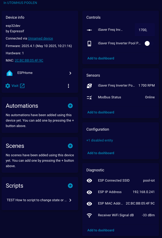

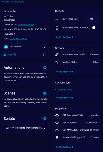

I finally made this work a few month ago, thanks to @milwhite + others here on the community. BIG thanks to everyone.
After I got told that the iSaver isn’t using standard modbus protocol and received the tip on what hardware to use I manage to build by own smart remote. ESPHome is installed on the ESP32.
In Home Assistant ESPHome integration I can turn it on and off, change the RPM and monitor current RPM. However the basics in the interrogation isn’t very smart or user friendly. I’ve created a logical “remote” function that is controlled from the UI front. I decided to use Nodered for the automation controlling the to the entities in the ESPHome integrations. They could easily be moved over to HAs Automations with some hours of work.
This summer season have proven this is working well. With the experience I now have I plan to develop and improve the automatic functions to be more convenient. Example after a power cut, there need to be a process checking a few sensors and if the pump is suppose to be running, then execute the command to start and set to required RPM. If something indicates an error it will send notifications via HA and mail.
Everyone! Grateful for all the help. Happy with this :slight_smile:
