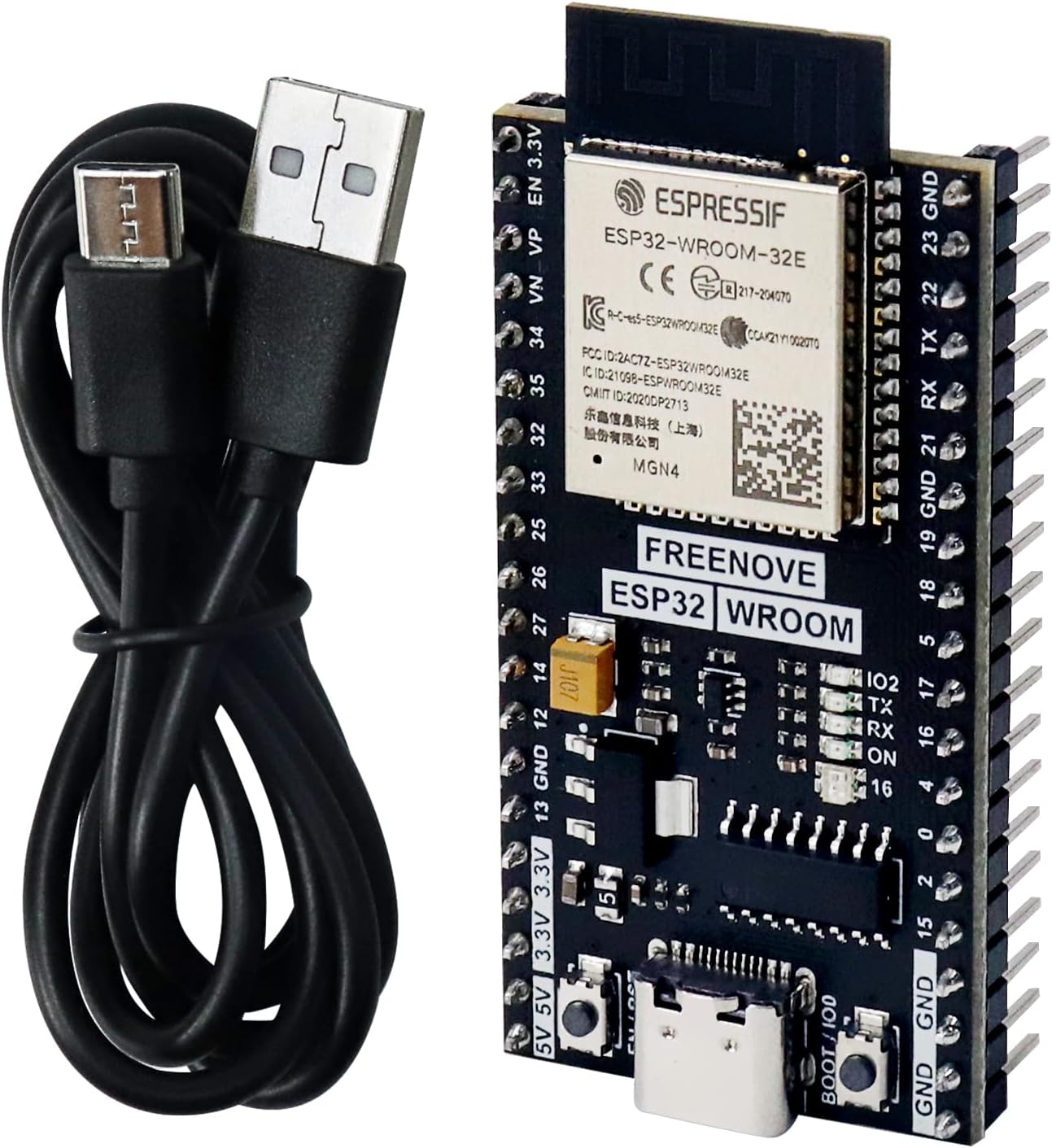

Yes the ESP 32 board.
Not an expert but I have to flag that I’ve had issues with another models. There seem to be differencies in depending on chip structure and connectors. If you’re into details and have the knowledge of the ESP32 boards you might be able to figure it out.
However, I picked the AZDelivery ESP32 Dev Kit C V4 NodeMCU
Amazon SE Link to AZDelivery ESP32 Dev Kit C V4

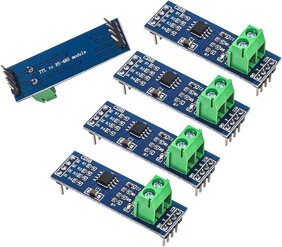

The RS485 module
I guess most modules are ok to use. I picked this one
5 V MAX485-modul RS485-modul TTL till RS-485 modul konverteringskort kompatibel med Arduino
Amazon SE link to MAX485-module

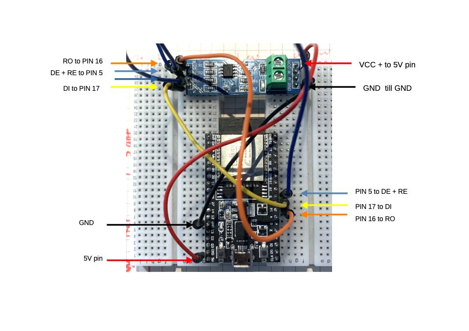

Tip! I found the PCB Breadbord handy as I dont have a 3D printer to use
iSaver Inverter control with ESP32 + RS485
To help the ones that have limited knowledge.
MAX485-modul RS485-modul TTL till RS-485 (works with AZDelivery)
Make sure you have proper 5V supplier
Connectors in the i Saver are marked.

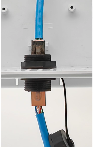

Use an old Ehternet cable.
I wanted to have the option to disconnect the controller from the iSaver.
I recommend a Water safe RJ45 Ethernet connector with my controller. Picked a cable with outdoor RJ45 plug . Not as in this image that is annother indoor project but similar.

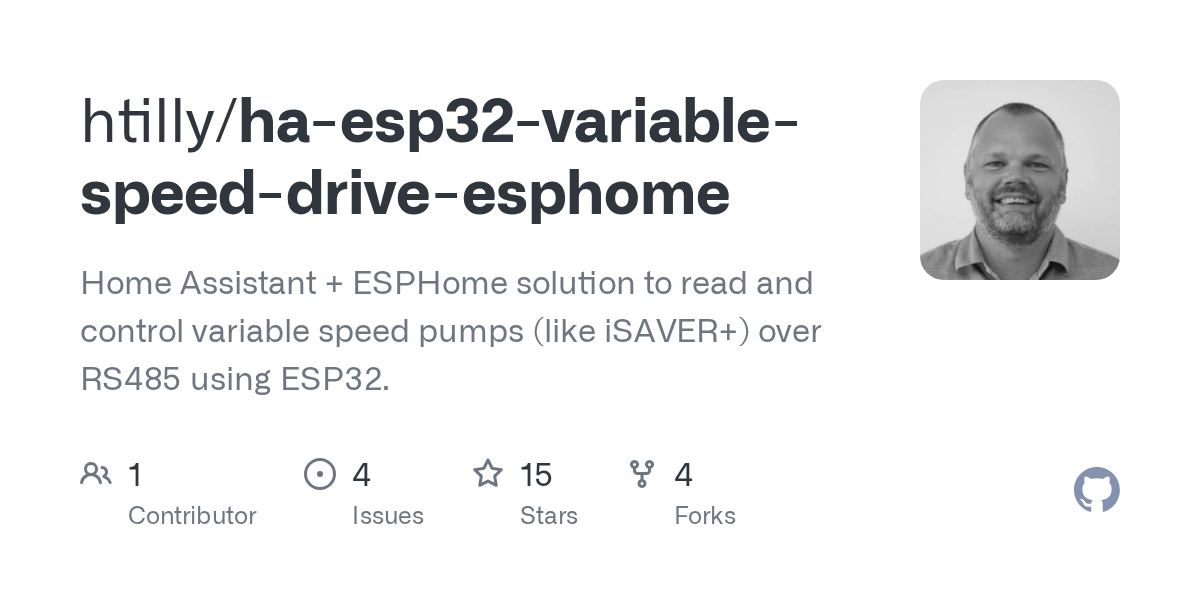

I can share my ESPHome setup yaml code to help you. Please go through the code and make the important changes to make it work in your network and home assistant.
My Github with ESPHome YAML code

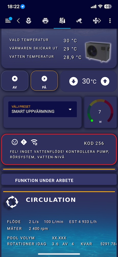

I created a first UI version last year but I am planning on develop an improved UI design this spring.
I only have the ESP32Home Yaml code to share at this point. However that can be used with the UI that he created. MAKE SURE YOU MAKE CHANGES TO THE CODE TO WORK WITH YOUR SETUP.
Link to my Github with the YAML code vers 2025.10

Example early version and look UI for heater.
Planning developing this into something better.

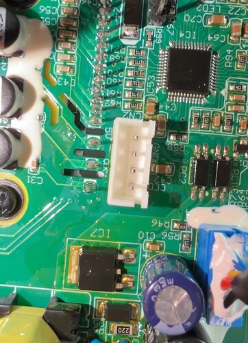

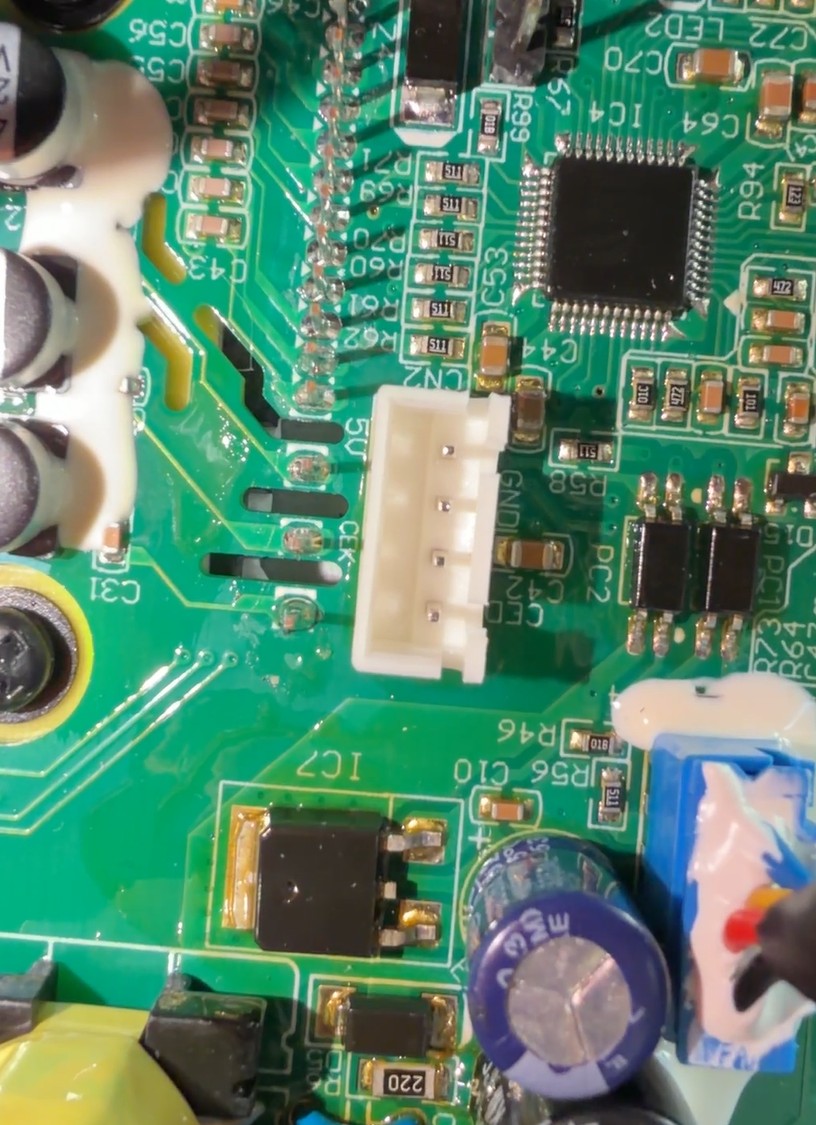

My iSaver doesn’t look quite the same inside but I hope I can get it right anyway. I hope i can connect it here.

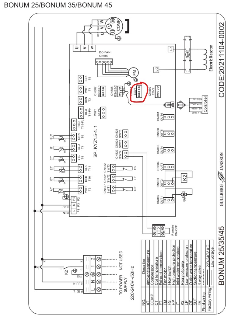

I have a G&J heat pump and use modbus to HA. Works great.

What is the model name on your iSaver frequency unit? Most of them seem to be the same inside, only a different brand on the box.
So are you using regular modbus control for othe heat pump?
The one we got has Tuya (local) and works OK, however its a bit annoying and I dont like to be depended on external services. Did found some connectors on the board and they all seem similar when it comes to the control board no matter what brand.

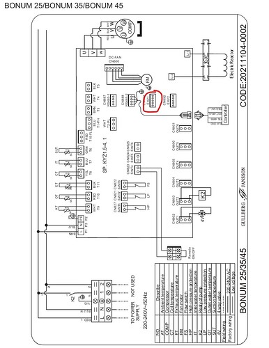

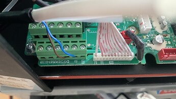

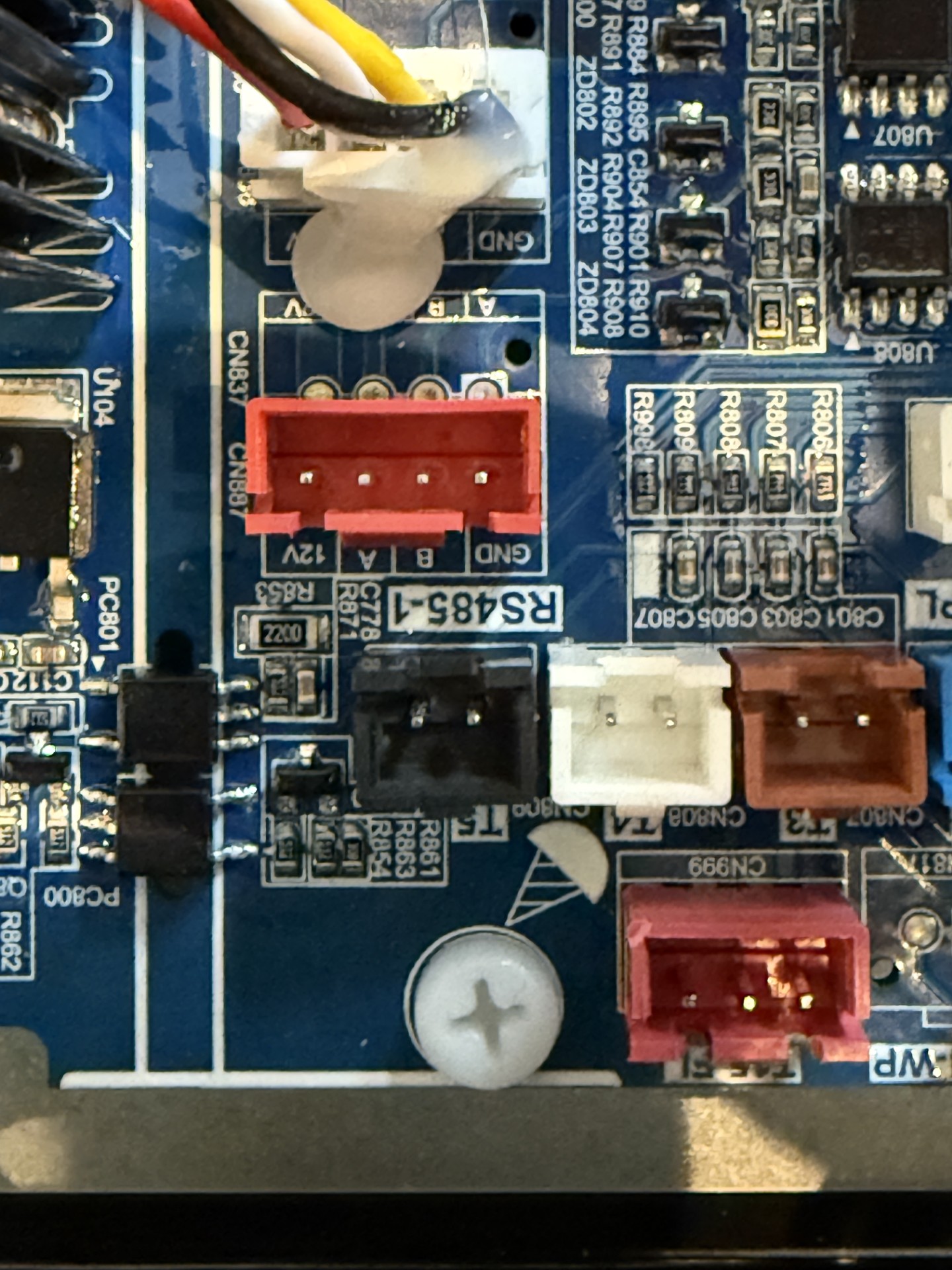

This i how i look inside my heat pump. Looks like it was similar on many as u say.
Use https://www.amazon.se/dp/B09PD5ZD56?psc=1&ref_=cm_sw_r_cp_ud_ct_GZS4AHA4Y0X3J88942E4 to connect to wifi.
One more pic…

I have a G&J pool pump inverter. It looks exactly like your picture.
Were you ever able to connect through the connector in the image?
Thanks!
AndersLA, were you able to use the white connector on your iSaver1100? I can't find out whitch pins that are A/B.

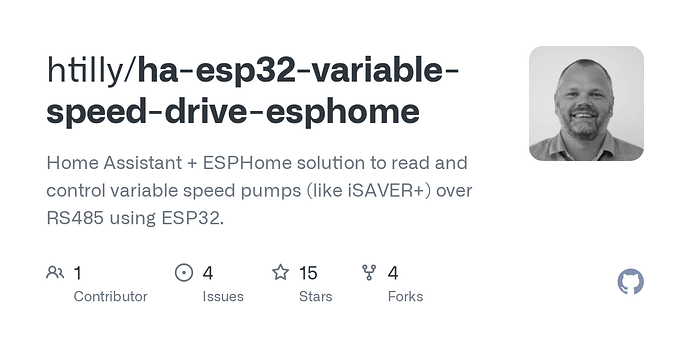

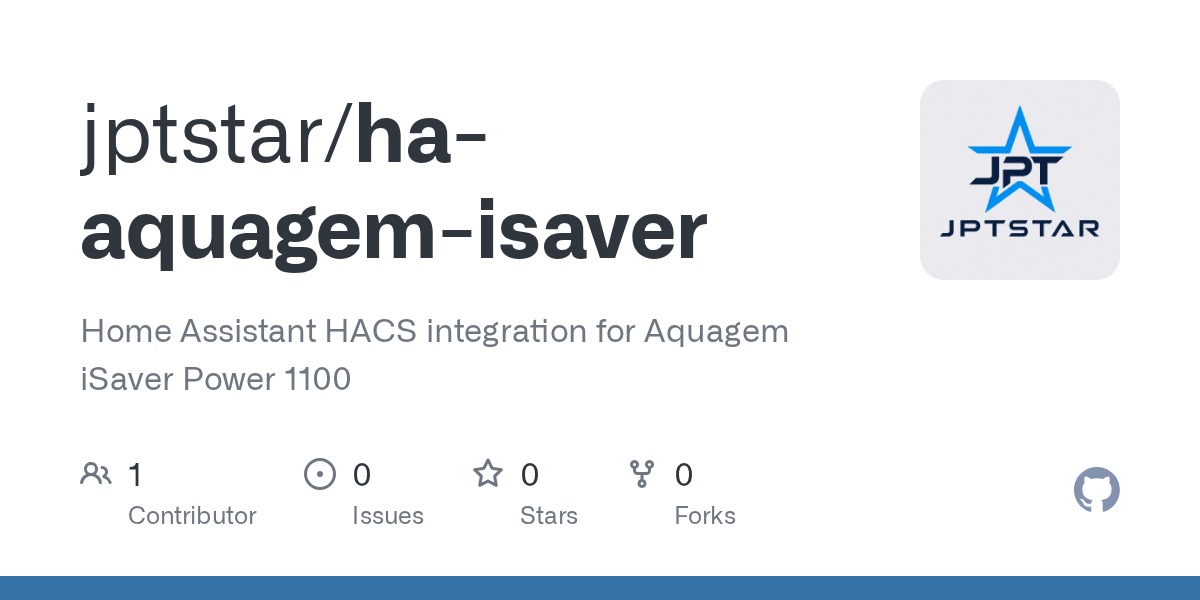

I connected my Aquagem iSaver 1100 using a Waveshare Modbus RTU to TCP adapter and developed an integration that works well.
Everything is explained in the repository (HACS)
