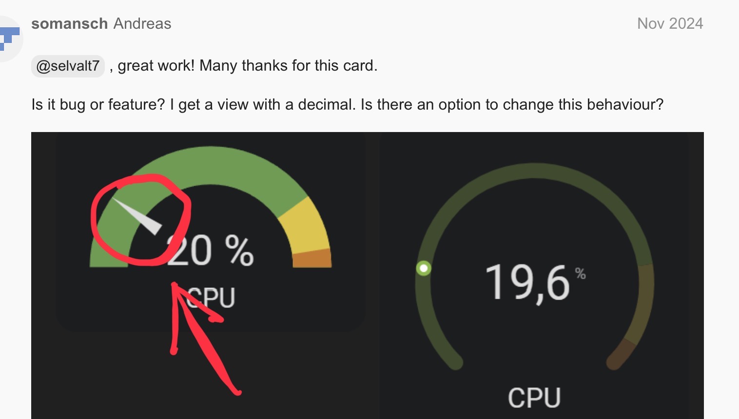

Just have to ask, is there a way to display som kind of actual needle? I LOVE this card because I can change so much, and the “needle dot” is ok, but I have a design in mind that would be so much better if I had all the customisation with this card but some kind of actual needle
I’m not sure what you mean with “some kind of actual needle”,
but I am using this code to modify the needle look to my needs.

In the image above your last comment I have drawn on the image on what looks like a needle, I would prefer just a line from the center of the gauge, or a long arrow, but really anything except just a dot.
But it seems like you can modify the look of it with your code, but cant get it to work. Would you consider sharing a complete YAML block for one you have made so I can see where I go wrong?
Sorry, I made a mistake. My code was not from the modern-circular-gauge it was from the gauge-card-pro which looks partly compareable. So maybe the needle of this gauge here cannot be modified.

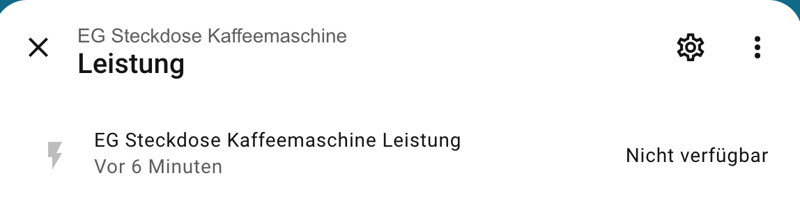

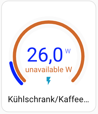

I love the Modern Circular Gauge Cards and I use some for Zigbee Plugs. Not all of these Plugs are online the whole time. When the source is not available the Modern Circular Gauge shows the full circle, like maximum power. Is there anything I could do to set it to zero instead?
When entity state is unavailable card should reflect that and do not show the full circle, only the gauge background is supposed to be present with state displaying localized “unavailable”. But if you want it to display zero instead of unavailable you could use templates to do that.
Maybe your entity state is not really unavailable and card is confused displaying full circle. Some images would be helpful to diagnose it.
Hi, thank you for your answer. I think that the entity state is really unavailable. I will show some screenshots of my problem. I don’t need a real “zero”. I wrote this some misunderstanding. I want not to see the full power circle when the entity ist not available.
If you need more information let me know what you need.
I am not allowed yet to post 2 Images simultanously.
I thought that the problem was with primary entity but thanks to your screenshot I know that the secondary and tertiary entity has a bug with unavailable states.
I will try to release a new version with bug fix and a few new features hopefully next week.

It works :smile:. Thank you very much. :+1:t2:

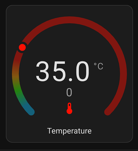

Liking this card so far
 yet to play with it too much, but I’m stumbling on the very first hurdle. I’m copying the template for the creation of the temperature graph.
Do I need to do something to make these extra items in the templates work? Is this automatic, or is this something else I have to somehow create?
secondary:
  entity: >-
    {% if is_state("binary_sensor.outside_zigbee_temperature_rising", "on") %}
    Rising {% elif is_state("binary_sensor.outside_zigbee_temperature_falling",
    "on") %} Falling {% endif %}
max: "{{states('input_number.max_number')}}"
It’s creating the max temperature super high, when it should be around the 35ish, it is reading now. At the moment, it looks like it’s around 100 (God, I hope it doesn’t get there).
I don’t know how I could create a binary sensor for rising or falling manually :confused:
What’s the state of your input_number.max_number helper? Do you want to use other entity for max gauge range or set it static to some value?
To create a binary sensor for rising and falling you can use trend helper.
