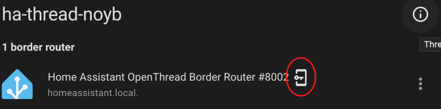

I’d like to draw some attention to the small icon on the ā€œPreferred Networkā€ screen:
If it is missing, these steps for Sync Thread credentials must be repeated quite often. The icon is brought up via the three-dot menu ā€œUsed for Android + iOS credentialsā€.
