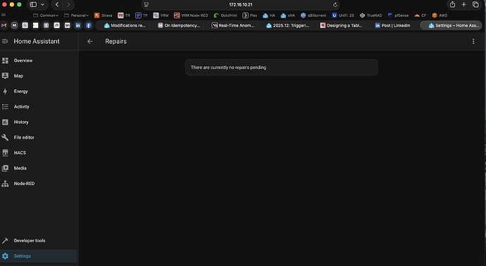

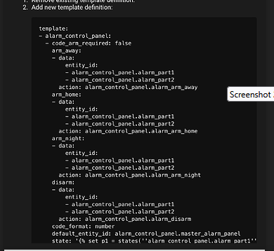

Did you read the repair notice in your HA settings? What did it say?
this is all that was shown to me.
will go read the above Deprecuation note and see if I can figure out what I need to do.
G
What does bullet 1 say?
what does bullet 2 say?
What does bullet 3 say?
Sorry to be a bit abrasive here, but it gives you directions in the repair.
I figured that was my template.
Leading to not knowing what to replace it with.
Looking at your comment it seems to be the new to be replacement?
think bullet #3 was reboot system?
G
As I took a screen shot…
how where can I access this new template replacement again?
G
You’d have to go back to the old definition. If you just post what you’ve tried I can attempt to fix it for ya
I haven’t changed anything yet.
Your comment was that that proposed replacement yaml was given by the system, I only took a screen shot.

Did you ignore the repair? If yes, you can unignore it in the settings system repairs menu
I probably did…
but by going to settings/system/repairs it’s saying nothing to unignore.
G
confirmed the code in my configuration.yaml is still the old code, compared it to a backup copy of my configuration.yaml that I had.
And ye, me = blind, did not realise the code shown is the code to use as replacement.
Going as per instructions above does not show me any ignored repair jobs.
Is there a way I can get that full code as per the repair back, so that I can copy into my configuration.yaml.
G
… anyone else able to assist please.
As said, I don’t recall hitting on ignore, but it does seem to have been, I also can’t undo whatever ir did to get the “suggested” repair back.

Not to be difficult, see attached… no repair.
might a restart of the HA stack “make” it trigger a repair advise again ?
G
click the 3 dots and show ignored repairs.
awesome, thank you.
Did not notice the …
The message that there was no ignored repairs sort of distracts you.
Copied the template into configuration.yaml and commented the old alarm code out, restarted HA and all still looking as it was.
Appreciate pointer to …
