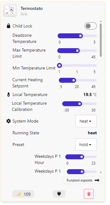

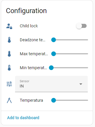

When attempting to set the Deadzone Temperature or Max Temperature Limit, the Min Temperature Limit unexpectedly changes to 1°C. Additionally, the current heating setpoint sometimes jumps to 5°C or 45°C.

Here are screenshots of the current configuration:
Zigbee2MQTT Logs (repeating entries):
[26/11/2025, 15:34:18] z2m:mqtt: MQTT publish: topic 'zigbee2mqtt/Termostato', payload '{"child_lock":"UNLOCK","current_heating_setpoint":20,"deadzone_temperature":null,"heat":"ON","linkquality":109,"local_temperature":19.5,"local_temperature_calibration":null,"max_temperature_limit":null,"min_temperature_limit":1,"preset":"hold","preset_mode":"hold","program":null,"running_state":"heat","sensor":"IN","system_mode":"heat"}'

I don’t own the device, but the device page in Z2M explains what each parameter does.
eg. The jump you’re seeing in Min Temperature Limit is actually the value going from null to 1, which is the minimum value allowed.
I have no idea why you’re seeing those jumps, but I have a feeling it’s because your HA dashboard & your zigbee dashboard are showing different values. Deadzone Temperature is the parameter you would use to ensure heat is called if your local temperature and your temperature are different by X degrees.
What’s weird is that:
  • HA dashboard shows the deadzone slider all the way to the left (0 or null)
  • Z2M dashboard shows it set to something like 3
  • MQTT message shows "deadzone_temperature":null
Maybe it’s because you removed those “similar entries” and that was the first message, before any updates? Can you double check whether the latest messages are identical (and not just similar)?
