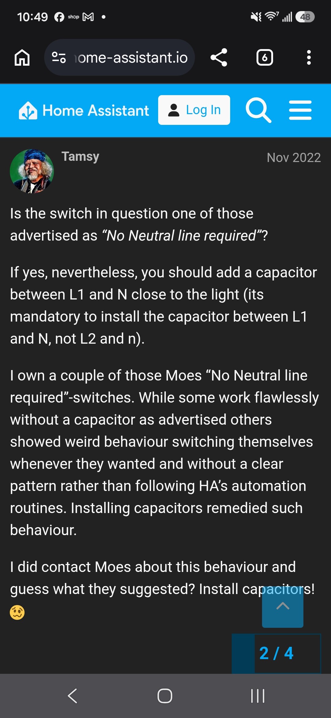

I'm here asking if a capacitor would work bc there's a post from 2 yrs ago saying it should help. However, I spent 2 days getting dicked around being told by the moes offical ebay seller that basically the switch is designed not to need a nuetral or capacitor and they've not explicitly refused to send me some, but basically keep reiterating that it doesn't need them.

It really doesn't. That screenshot you posted refers to light switches, which typically have no Neutral available. That's when you need the capacitor hooked up between L1 & N so it draws enough parasitic power to keep the device on.
What you have is a power outlet which does have a Neutral. A capacitor won't help with that since you want something on the output, like a dummy load.
